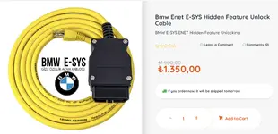

In that case, I will just return Openport 2.0 without even trying it. Since VXDIAG VCX SE is not available in my country and it is very expensive to buy it abroad, I am thinking about buying this cable. What do you think? Is it compatible? Is it possible to code with DTS Monaco 8/9?
ENET is suitable for DOIP models like W206, W223, W297 etc. But will not work with W167, W117, W177 etc.
