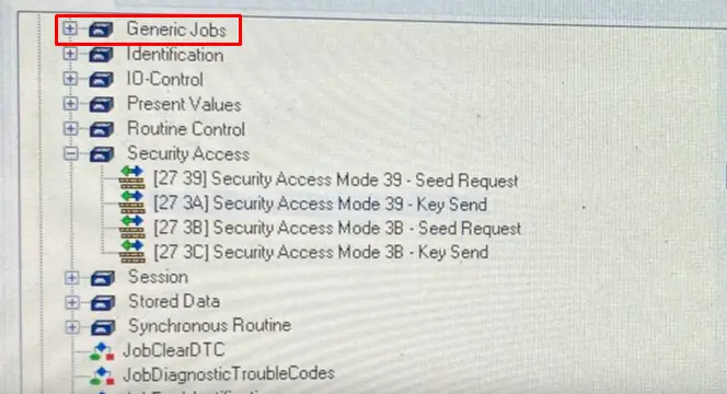

Change the project.
The unlock code calculation algorithm is incorrect, try other calculation tools.
Go to the "Generic Jobs" tab and there are ready-made commands for this.
What do you need to do? For the EZS167 module, unlocking with the seed key is not required.
I want to change the language in HU6, for example I want to make headlight adaptation. In short, this car is from the US and now in Europe, I want to change several things, but with this firewall I can't do anything. Also I can't remove the check engine light, suspension adaptation...
Can someone tell me why everything in my car is blocked?
Go here and open level 3B. This will disable the firewall.
1739275416875
Reactions:Penyo and BIBSHIGE
But after coding HU6, you still need to run a special command, otherwise the codings will not be saved.
Reactions:Dervo90
What command do I need?
