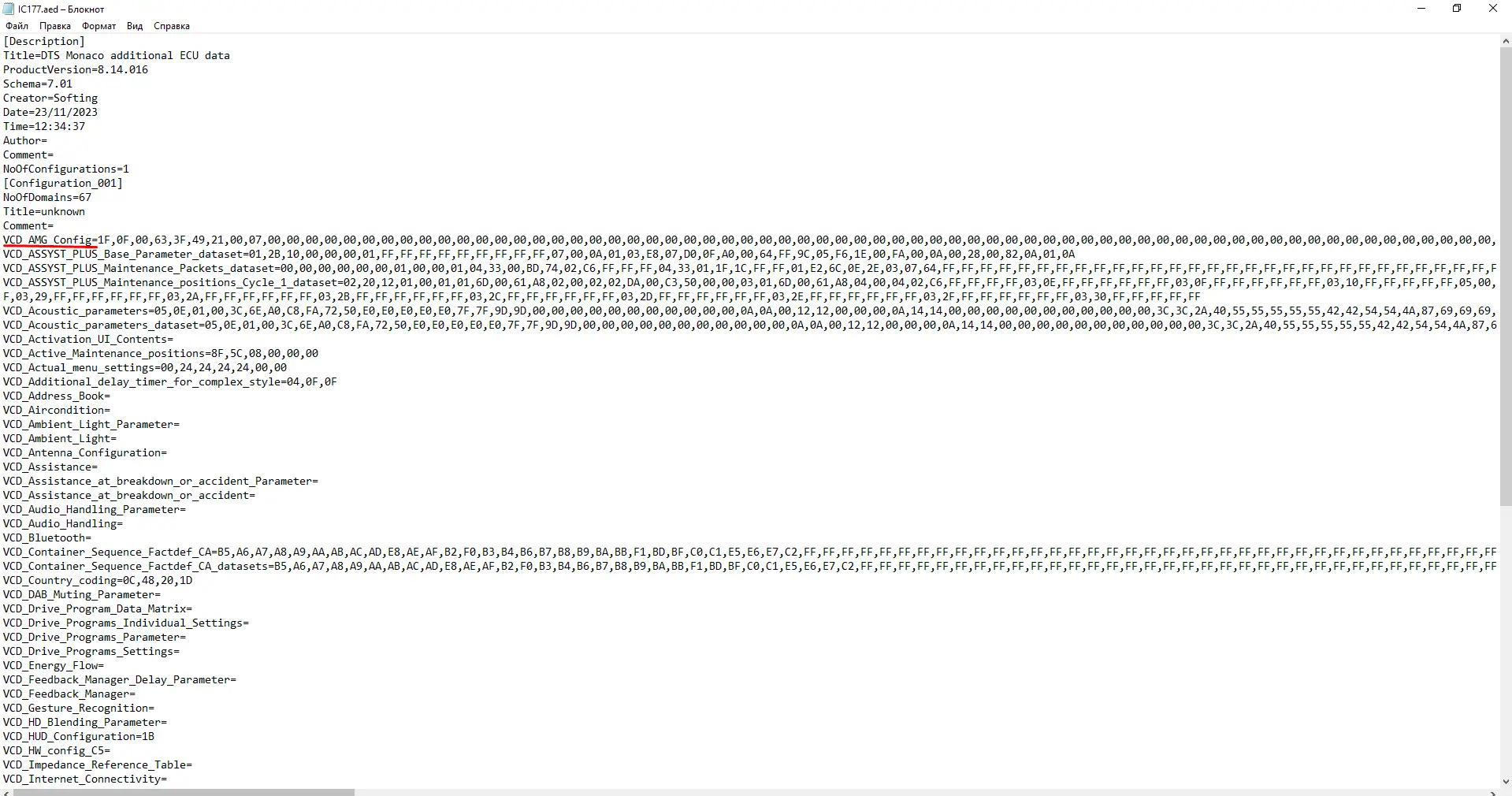

You need IC177. Only SMR-D and DTS Monaco. For example.
1741240196838
There are CBF and SMR-D files that allow connection to the ECU via DTS Monaco and Vediamo.
To flash the ECU, CFF and SMR-F files are used respectively (it is not recommended to flash the ECU using Openport 2).
Vediamo is very useful for older models (up to MY2016, approximately). While DTS Monaco is suitable for both new and old. For DTS Monaco, you can choose CBF or SMR-D, which is more common for new cars.
If you have an Openport 2 interface and are using DTS Monaco, please note that you can only connect to the ECU via SMR-D.
It is best to save a quick Xentry test PDF containing all ECU hardware and software components, and also backup all ECUs via DTS Monaco before you start working on the codings.
