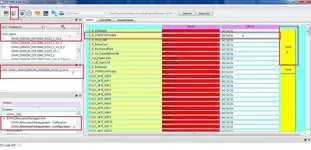

Hi Simone,
I have read on another forum that it is possible to disable Start/Stop on the 451 via software, (unfortunately the thread stopped with 'Solved').
The little information available states that the setting is protected by a seedkey so Vediamo or DTS used for change, my best guess would be to look at the ECU or RSG parameters.
On the 453 I think this setting can be changed using DDT4ALL.
Regards.

There is also a mod that automatically turns on the center button on every startup, resulting in a de facto "always off" Start/Stop. Costs about 25-50 euros depending on the source, will have to look for where I got it. Works flawlessly.
Find "Smart Fortwo 451 MHD Start/Stop Deactivation Automatic switch".
453 can do 451, maybe.
