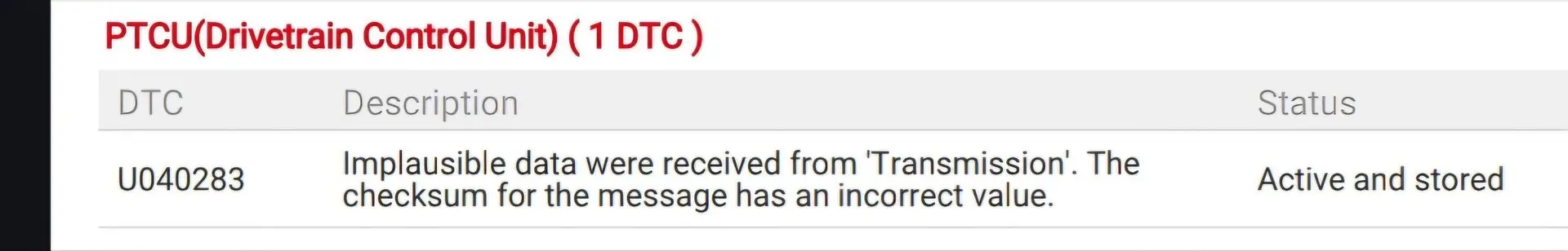

You are right that the problem is related to the PTCU. After the failure in stage 1, I thought that updating the transmission software might solve the problem. The update and coding were successfully performed using Autel Ultra. After the update, the only fault that appeared was in the PTCU.

Most likely the torque limiters in the ECU map are higher than the limiters in the PTCU map.
On these cars the PTCU also needs to be flashed, but as far as I know there are no such programmers at the moment.
The best solution would be to adopt other strategies for stage 1 in the ECU maps.

I also know this problem and drive the same engine. The problem is caused by CPC_NG because the torque limit in your file is higher than what CPC allows. You can counteract this by coding and lowering the limit in the tuning file, then the error and jerks will disappear.
Send me your file and I'll take a look at it. I can send you my file, but you'll have to change some data in a hex editor and fix the checksum for the machine to accept the file.
Code:
Coding this in MRD1:
Getriebe NAG3 V-Sport (AMG)
Momentenkorrektur dynamisch Mdyn nicht aktiv
Coding this in CPC_NG:
Leistungsvarianten Leistungsvariante 0
Momentenbegrenzung MFVB Index Momentenbegrenzung MFVB Index 0
Overboost Overboost erlaubt
Try it, but it is important that the maximum torque does not exceed 498 Nm, otherwise errors will continue to occur.
