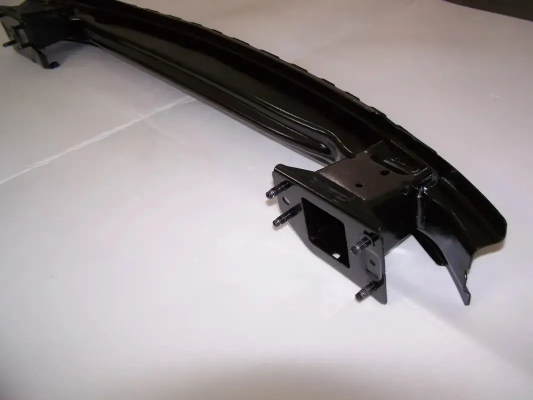

Can anyone share resources to help me replace the rear crash bar on a W205 2021 C300DE sedan?
I can only see the ends of two bolts out of four on each side (left and right).
We would greatly appreciate any videos or tutorials.

There are usually two on the outside of the car and two on the inside, and if you remove the interior trim, you can see them.

Thank you all. It was indeed not as complicated as I had anticipated, there were 2 bolts that I couldn't reach with an impact wrench, so a manual thin one and some patience did it.
