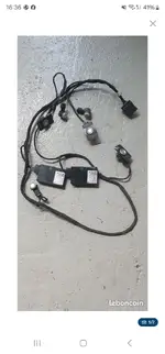

I found this one from W218, is it compatible?
The pre-facelift 2010 model with Distronic and active BSA system has two side sensors at the front. I think only the passive system has only two sensors at the back.
Without part numbers and your VIN code, nothing can be said. If it is compatible, then it is only a small part of the whole system. You will need a new mirror glass, a new mirror wiring harness, possibly a body wiring harness, possibly a door module, possibly a different ECU, possibly a new front SAM, possibly a new rear SAM.
I strongly recommend against installing this system. Buy a car with the system.
