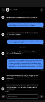

This was the last bit of the conversation that I had with the ECU flashing place. Is what they are saying, true?

The only way to check what he did is to read the dump.
Reactions:Organicrobot
Can this be done from the vehicle or does the module have to come back out of the car?
I don't know of any tool that can read the dump of this module via OBD. If you try to write your VIN on first start, it can be done via OBD.
Which program do it use? I haven't been able to download anything for the Mercedes yet, but is there one you recommend that can do this?
