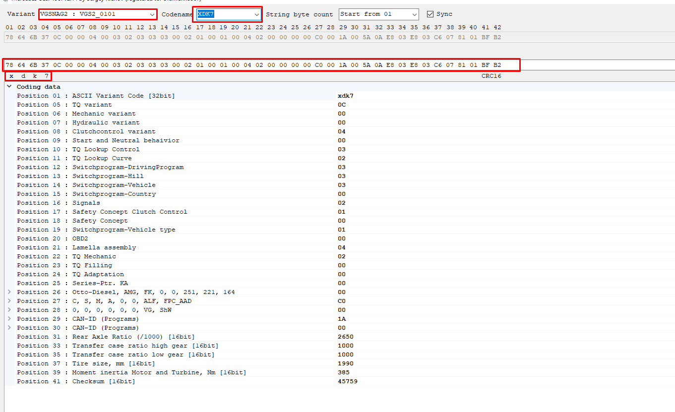

I need to do the correct coding on a 2014 W906 van OM651 VGSNAG2 for an AR3 ratio (4.182).
0009019400
SW 0039020000
WDB906613
SCN was read using Vediamo:
Code:
122 115 112 049 013 002 001 005 004 002 003 009 009 013 000 001 000 000 001 002 004 002 001 001 000 000 128 000 000 129 000 000 000 000 009 007 000 000 083 015 085 042
Reactions:SF2061

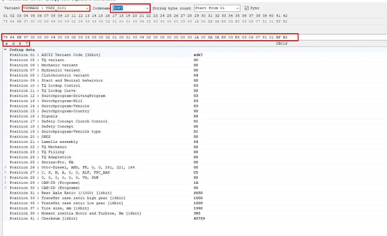

Post the coding string in a different format. DEC. And also the block variant (for example, VGSNAG_0101 and code name XDK7). The coding string display format can be changed in Vediamo settings.
1766217109321
Reactions:SF2061
This can be done using this program. You need to change the encoding from decimal to hexadecimal in the Vediamo settings, then paste the data here into this program, set your VGS version and make the changes. However, be careful not to do anything you don't know, otherwise you may break the coding.
  • VGSNAG2.Manager.v1.6.rar
Reactions:ikasimov0401 and SF2061
I changed the code string to hexadecimal format.
At first, an error occurred that prevented me from changing the coding, but after unlocking the ECU using Vediamo, everything worked.
Thanks everyone.
