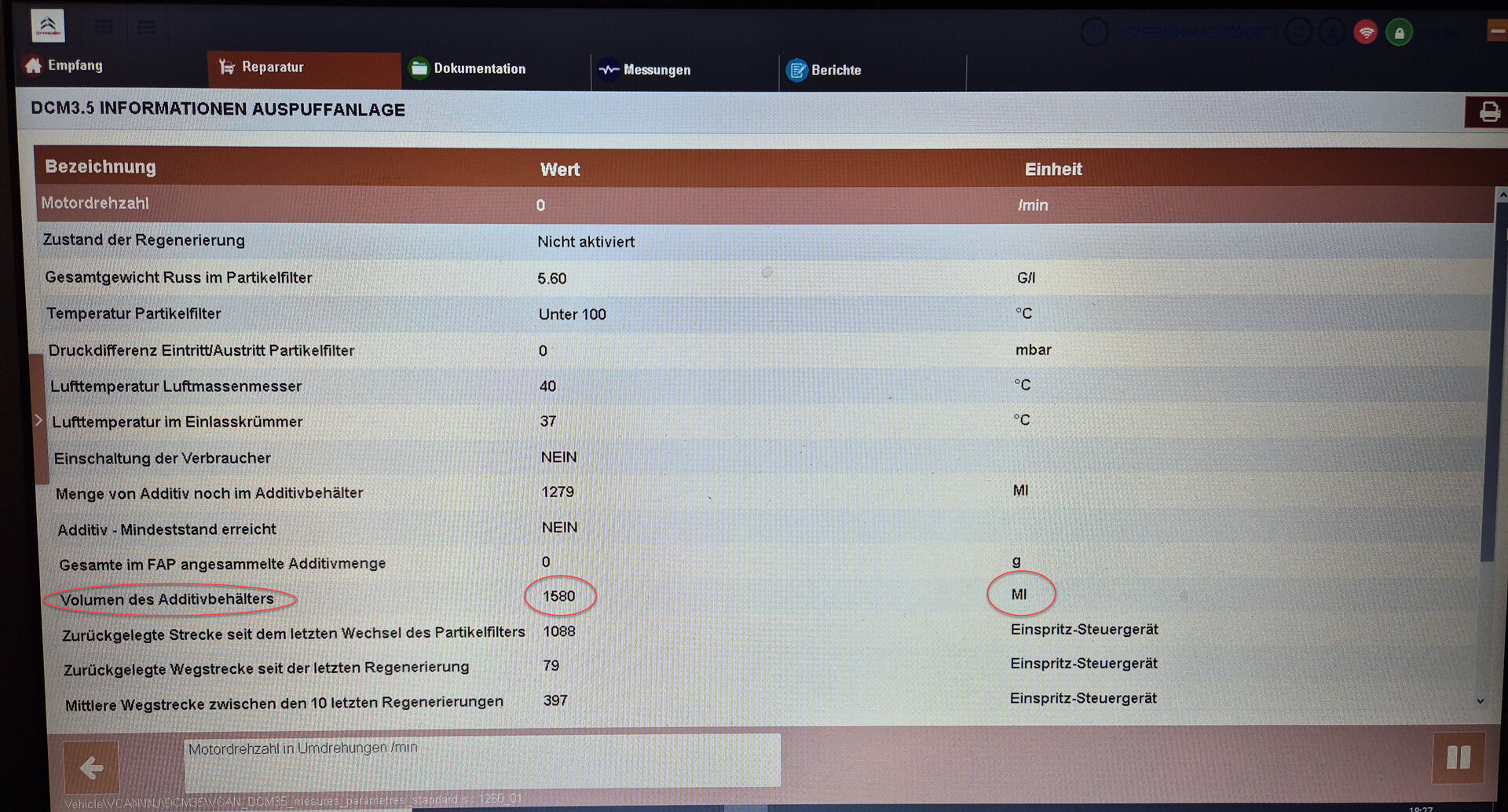

Can anyone tell me what the unit "Ml" means in Diagbox? I replaced the pump and added 3 liters, which means the additive tank should hold at least 3 liters. The entry "Additive tank volume" of 1580 Ml puzzles me.
And I'm not sure if it makes sense that the current fill level is 1279 Ml. There is no sensor in the tank, the level is simply calculated.
These are milliliters.
Reactions:rbl1 and Katja1984
Thanks, I suspected the same thing, but is something wrong?
The original tank holds 3000 ml, which is what I filled. Why is it programmed for a maximum fill level of 1580 ml?
