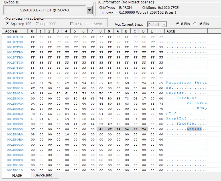

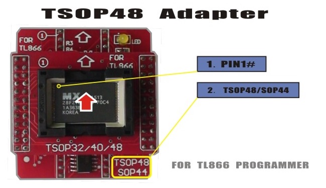

Removing information about the anti-theft system from NTG 2.5 from the gateway flash memory (TSOP-48) S29AL016D70TF01.
For example, read the flash memory dump using the MiniPro TL866 programmer and the TSOP 48 SOP44 V3 adapter, locate the lines 001FA090 and 001F8090, find the text AntTft within them, and replace it with 000000. Write a memory dump and NTG will never ask for the anti-theft system PIN code again.
Don't forget to make a backup.

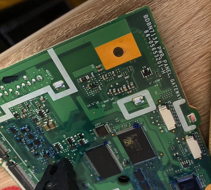

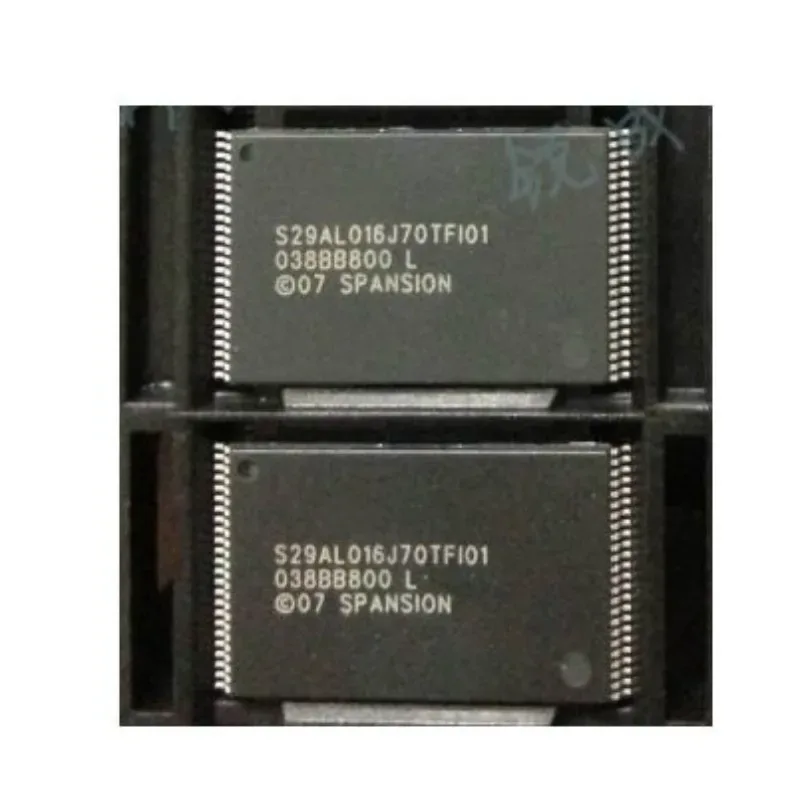

Thank you very much for the information. I immediately took apart my HU25, but I couldn't find the chip you mentioned. Could you please check which chip is indicated on the silkscreen: IC27 or IC25?
As I said before, you need to find the flash memory (TSOP-48) S29AL016D70TF01 (or the same name).
