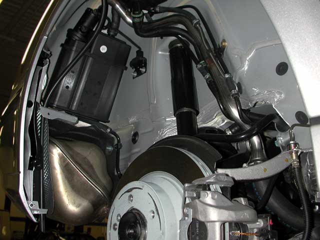

However, the ESP/ABS are on because I have a code 5120 B24/6 - right rear body acceleration sensor signal error. Okay, I thought I had disabled something. The problem is that this sensor doesn’t seem to be there at all. I can’t find it. WIS says it’s in the right rear wheel arch. There are two studs there to mount the sensor, but neither the mount nor the sensor are there. And never have been. I took apart the entire trunk, but I couldn’t find it there either. I took the back seat off and looked under it. Nothing.
Does anyone know where this sensor is and what happens to it?

Look at this.
