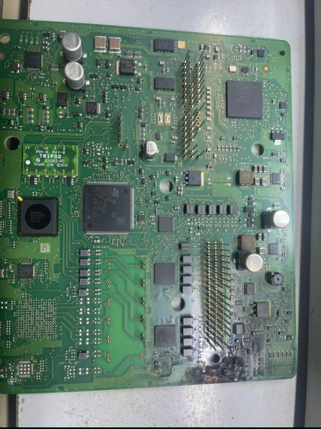

Hello, community! I am looking for expert help with problems with my Mercedes W206 EZS. If anyone has experience with this model and can give advice or support, I would be very grateful. I am ready to compensate for this help. Thanks in advance!

Have you replaced the module? Or is this an existing problem? Does the car start?
Reactions:chepz81

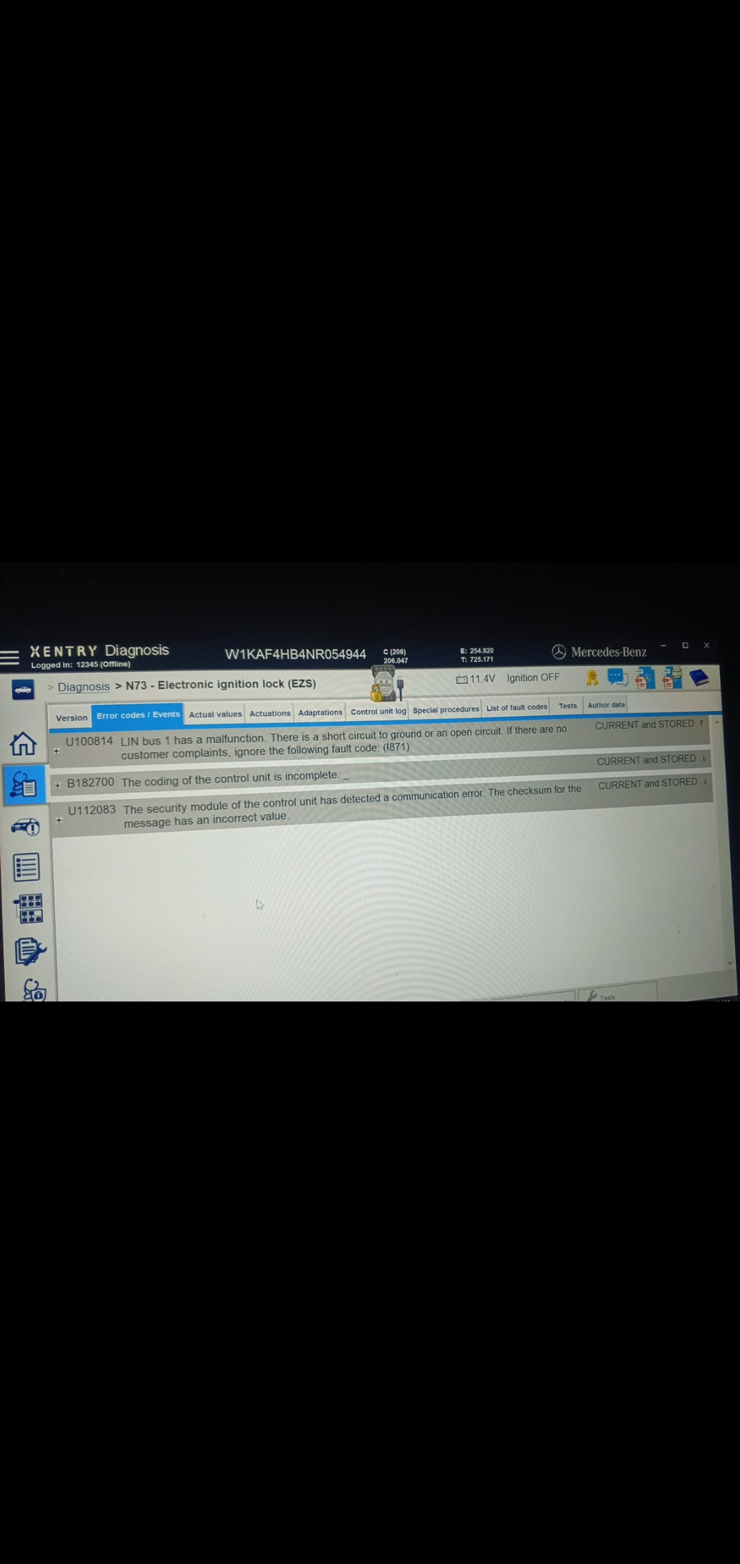

Yes, I bought a new key with EZS module because the car burned down.
Only an official service can fix this for you, since the EZS223 coding method does not yet exist.
Your unit is in good condition. Re-solder the controllers and external EEPROM modules (if present on the board) to the new EZS, and your car will be able to exchange data with the original keys.
In addition, even the dealer will not be able to install a used FBS component on your car - only a new one.
Reactions:fjvosm and samo
Okay, thanks, but please do you know the actual location of the EEPROM?
There is no external EEPROM, only internal in SPC58.
