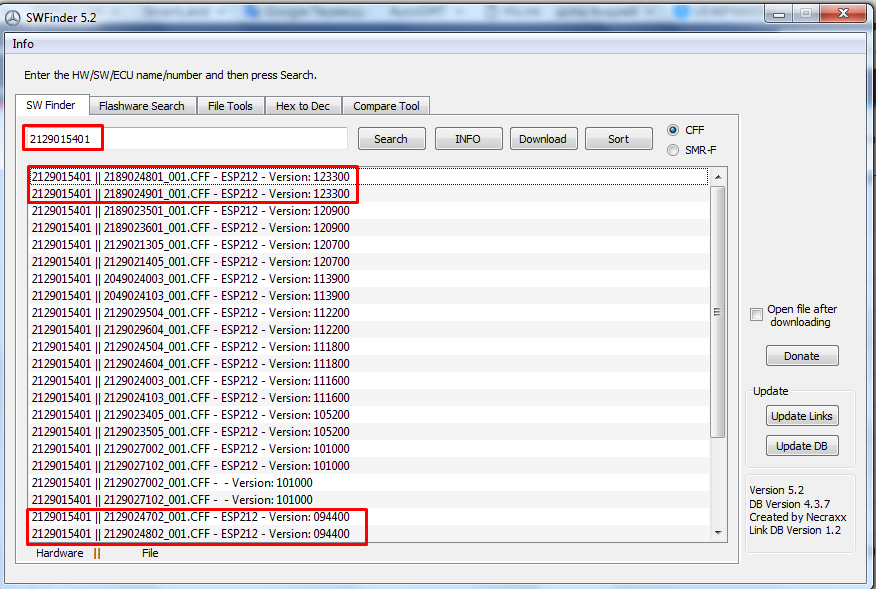

Try updating the ESP unit firmware. The unit version will change, and after that, additional options for changing codings sometimes appear. Also, check the coding options here. For example, W212080...2013 model year.

I updated the firmware. I coded it according to your example. There are no changes. The code is the same.
