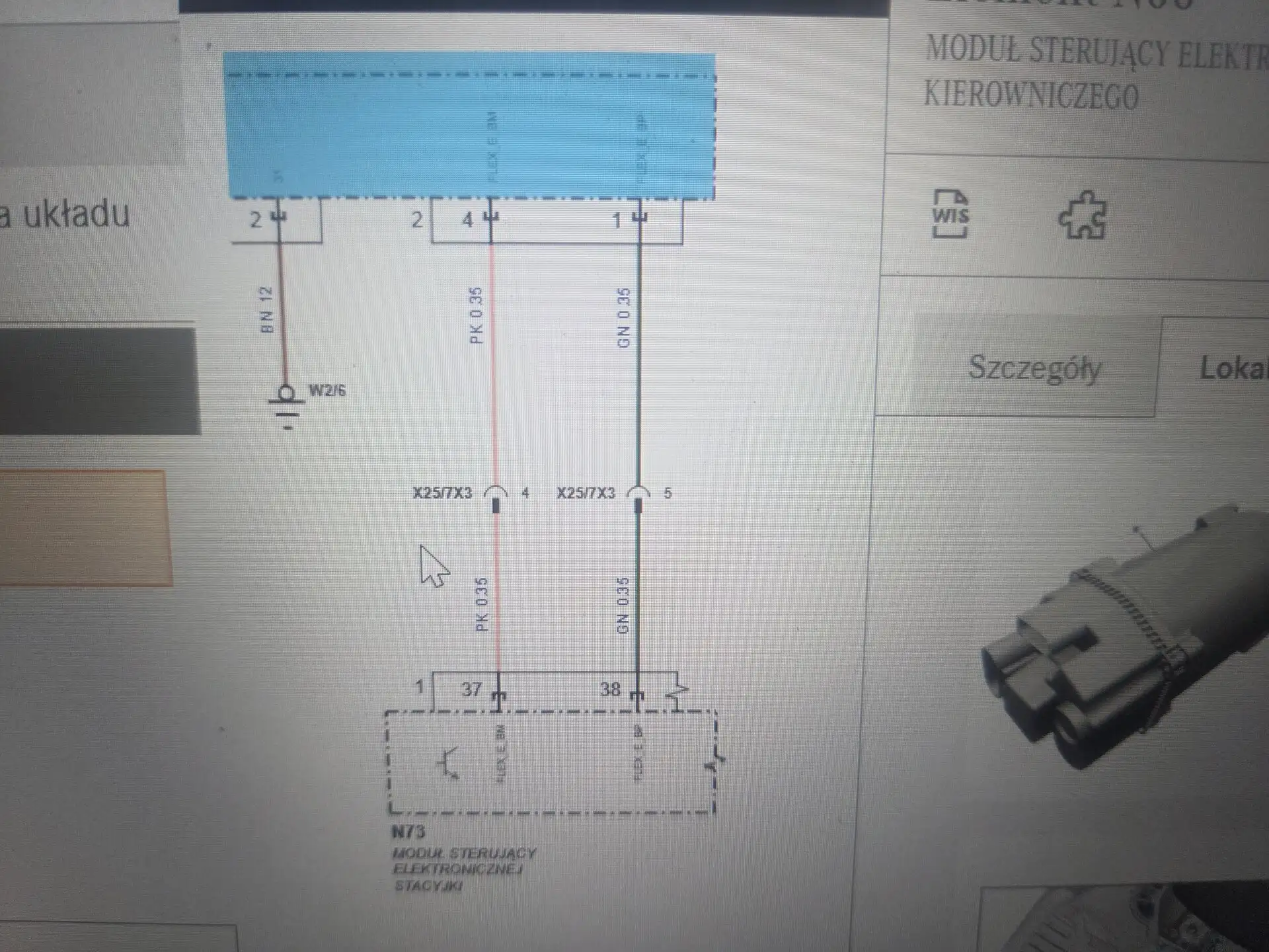

I found a diagram online on the XENTRY website. If it's accurate, there are no Flexray cables coming from the EPS connector.
The multimeter doesn't show continuity between the EPS connector and the EZS connector. The circuit on the X25/7X3 connector is intended for the EZS, but unfortunately not for the EPS. According to the technical diagram, the cable from the EPS goes directly to the EZS. Can anyone confirm this diagram is correct?
The diagram is certainly correct.
I connected separate wires between the EPS and EZS, and the EPS worked fine, and the connection with XENTRY also works. I need to find a break in the original cables or replace them with new ones. Thanks for your help.
