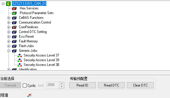

Unlock: 37 39 3B
Reactions:Mlima
You also need to use the appropriate EZS213 with the unlock parameters specified above. To unlock the gateway firewall, you can use the included EZS213.smr-d file.
