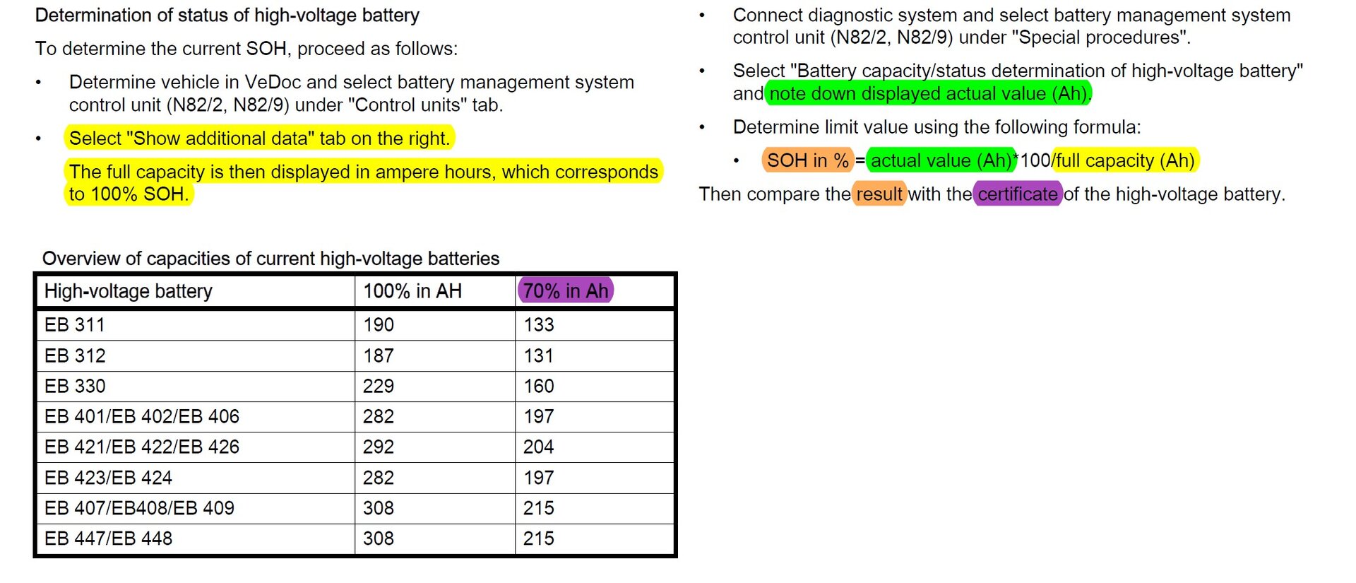

This is also correct - you can also use the method with a capacitance. See attachment. With newer AddOns, SOH can be shown as %, but for older versions of XENTRY you need to calculate it yourself. Plus, this data can also be found in the control unit log.
The battery type can be determined by the VIN code.
