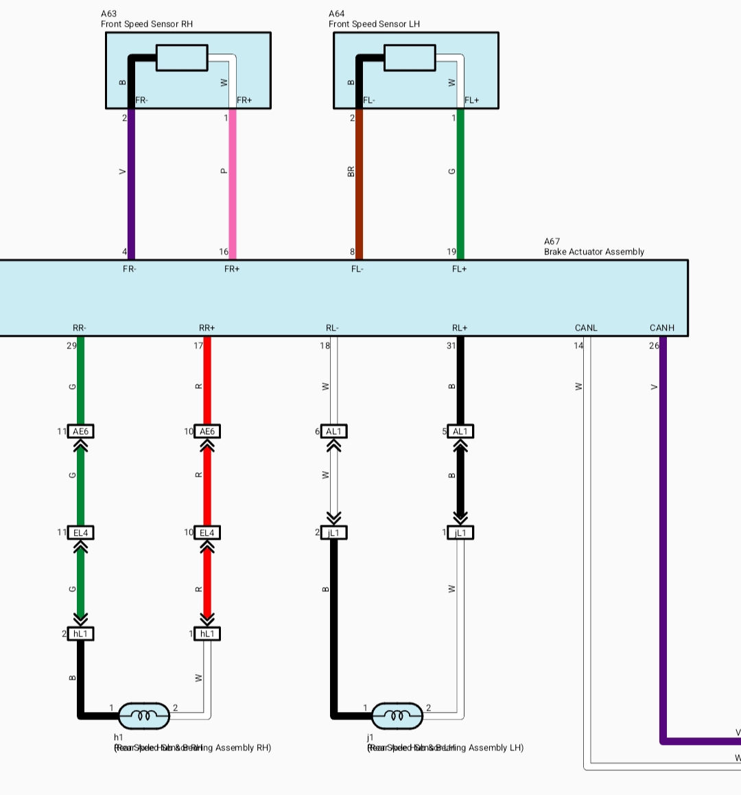

My guess is that your ABS module is most likely starting to fail and have issues since it is the contact point for all the sensors in your trouble code.
Reactions:mpaavi
