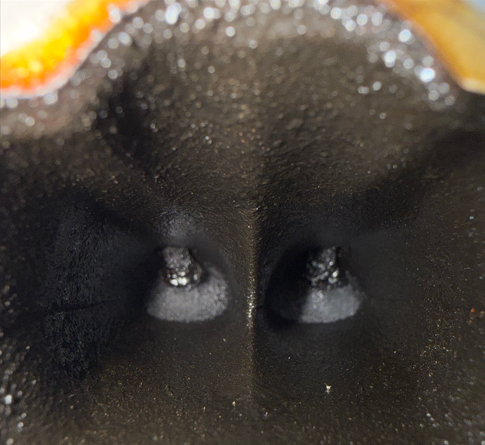

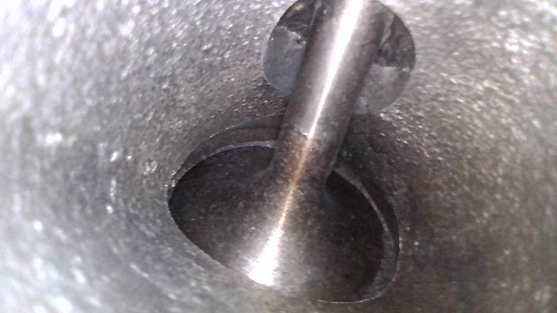

While monitoring the fuel trims, I noticed that the engine was severely starved for air, upon removing the intake manifold, I discovered the following.
Valves! The misfires disappeared 200 miles ago.

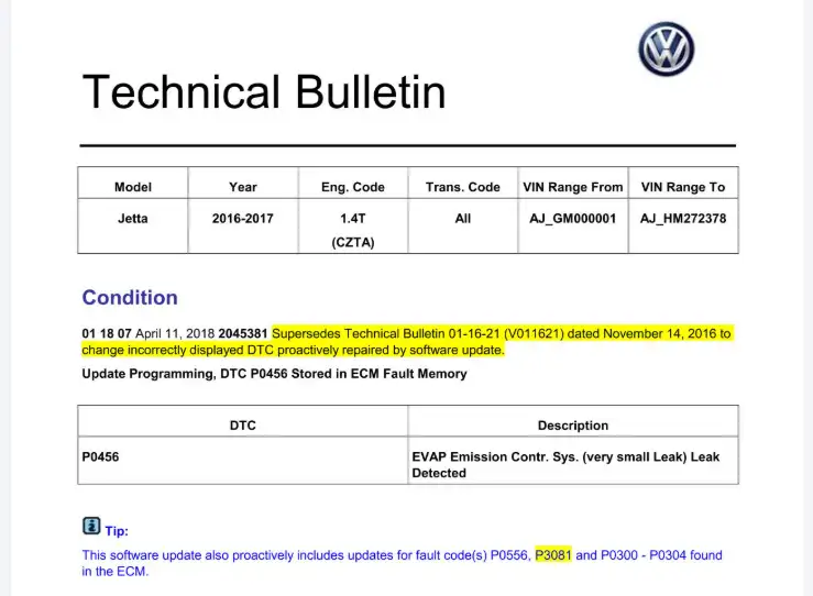

The car is back, error codes: P0456, P0301, P0302, P0303, P0304.

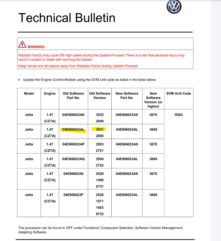

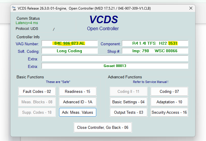

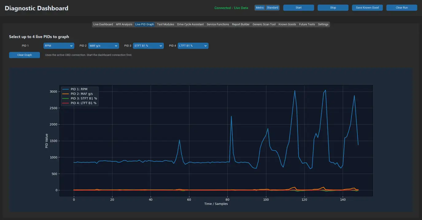

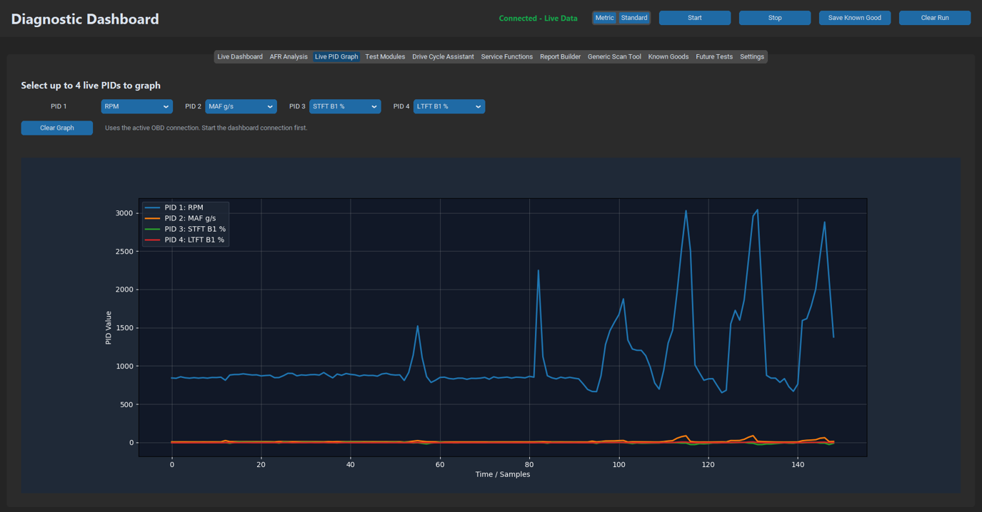

I now have a completely new ignition system, and fuel pressure is within normal limits in both the low-pressure and high-pressure circuits, furthermore, real-time parameter monitoring via VCDS suggests that misfires are, by all appearances, completely absent. The EVAP visual smoke test was successful, and after passing the tests for small and large leaks, the monitor indicated a normal status, and no error code appeared. I don't have ODIS, but I do have several J2534 devices, and I suspect this is a software issue.
Does anyone have personal experience using this firmware version, which resolves any of these issues?
