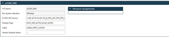

It works for me with this configuration.

I did what you indicated with *.reg but it still shows an empty vendor module name.
How could I solve it?
