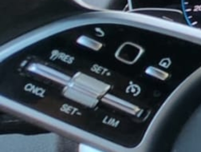

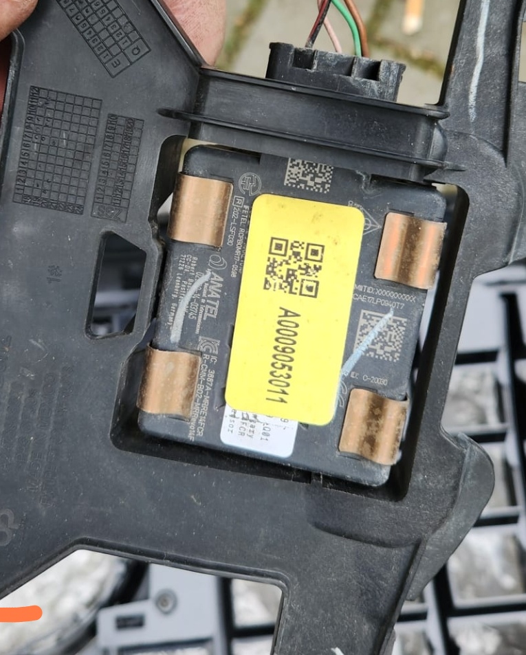

Can I install ACC on a 2020 Mercedes GLB with cruise control? The car has a front radar.

Yes, it's a pretty simple process, you just need to change the left buttons on the steering wheel and code EZS and FCW, then do the adaptation to recalibrate using XENTRY.

Yes, the adaptation for recalibration will be done offline and you will have to drive around a bit during the process with your laptop in the car.

First, you need to install a new panel with Distronic button. After that, you need to code and calibrate the radar.
Here are all the stages and ECUs you need to work with.
Code:
-> EVC CfgBit_01_32 Write
- 546 AUTOMATIC SPEED CONTROL -> ja
-> EVC CfgBit_65_96 Write
- 239 DISTRONIC PRO -> ja
- 258 FORWARD COLL. WARN.(FCW) W.ACT. BRAKE CONTR. -> nein
- 440 CRUISE CONTROL -> nein
-> Function SDTR Write
- Distance Pilot DISTRONIC -> active
- Speed Limit Pilot -> SL auto + manually
-> HU Delivery Settings SDTR Write
- Speed Limit Pilot -> active
It is extremely important to back up your configuration before making any changes.
