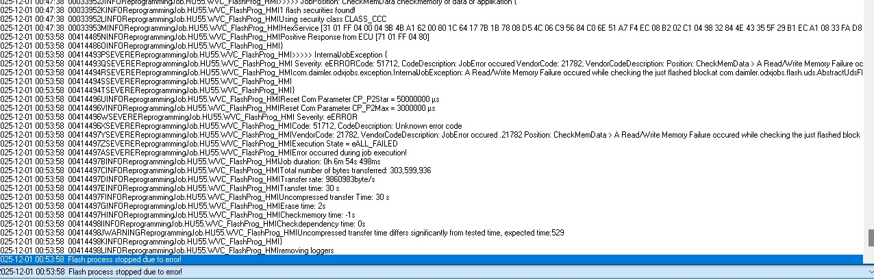

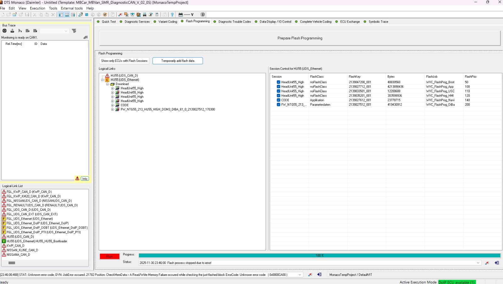

I have a similar problem (I think). My NTG55 radio gets stuck in radio mode when booting, unresponsive to any input signals. I tried flashing it with DTS Monaco via an ENET cable. Every time I tried writing data to the internal 2 GB SD card, I encountered an error on the 4th file. The card is encrypted, so it can't be read directly on a PC.
I'm attaching a screenshot of the error, which confirms that writing data to the "HMI" folder (a folder inside the 2 GB SD card) fails with a read/write error, which I suspect is related to a faulty SD card, but I'm not sure. I'm also looking for a solution to this problem.
