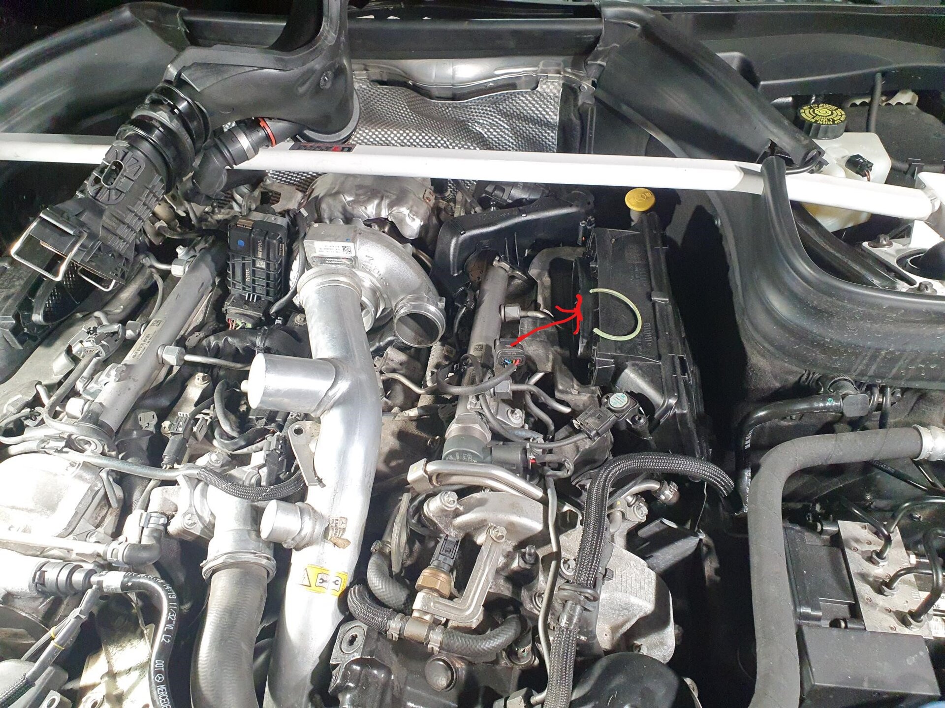

I think the sound was coming from the pipe connection between the turbocharger... there was a missing O-ring. After the repair, I opened the hose and checked.
Often mechanics lose or damage this ring when replacing the fuel filter. During the first 15 minutes of driving, the car may jerk when accelerating smoothly. Then no. In this case, no fault codes are registered.
