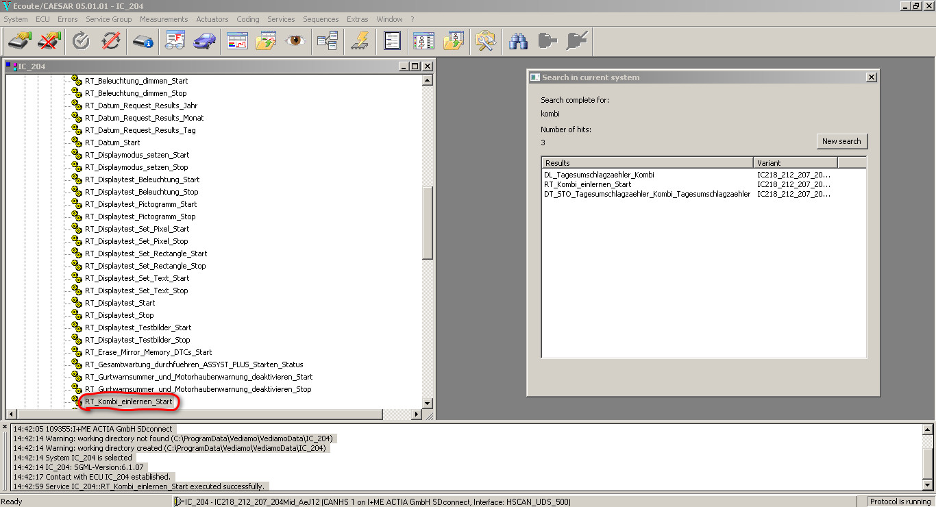

Can anyone help with information on synchronizing the mileage on a W212 instrument cluster? I created a backup in Vediamo and virginized the instrument cluster, but I am unable to synchronize the mileage - dashes are being displayed instead. I tried RT_Kombi_einlernen_Start in Vediamo, but it didn't work. Can anyone suggest an idea?

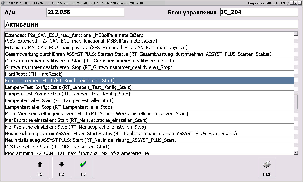

What does Vediamo report to you regarding this procedure? Has the mileage been reset to zero? It is possible that you performed a cluster reset and unlinked it from the EZS.
You can also perform this operation using DAS prototypes or via DTS Monaco.

RT_Kombi_einlernen_Start did not start in Vediamo console.

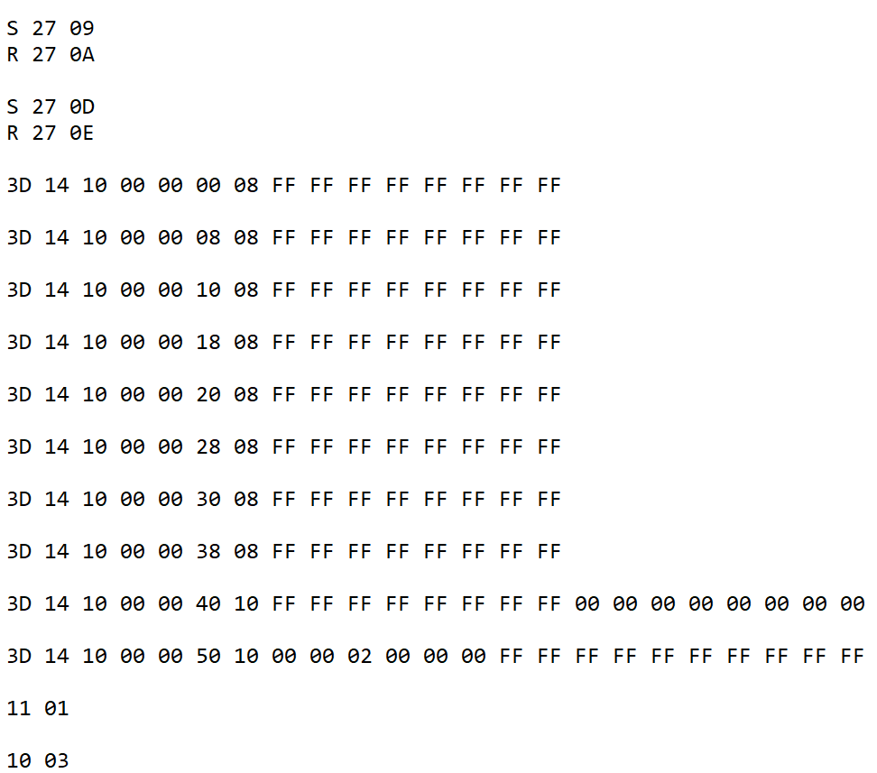

I unlocked the clusters and used this set of commands.
