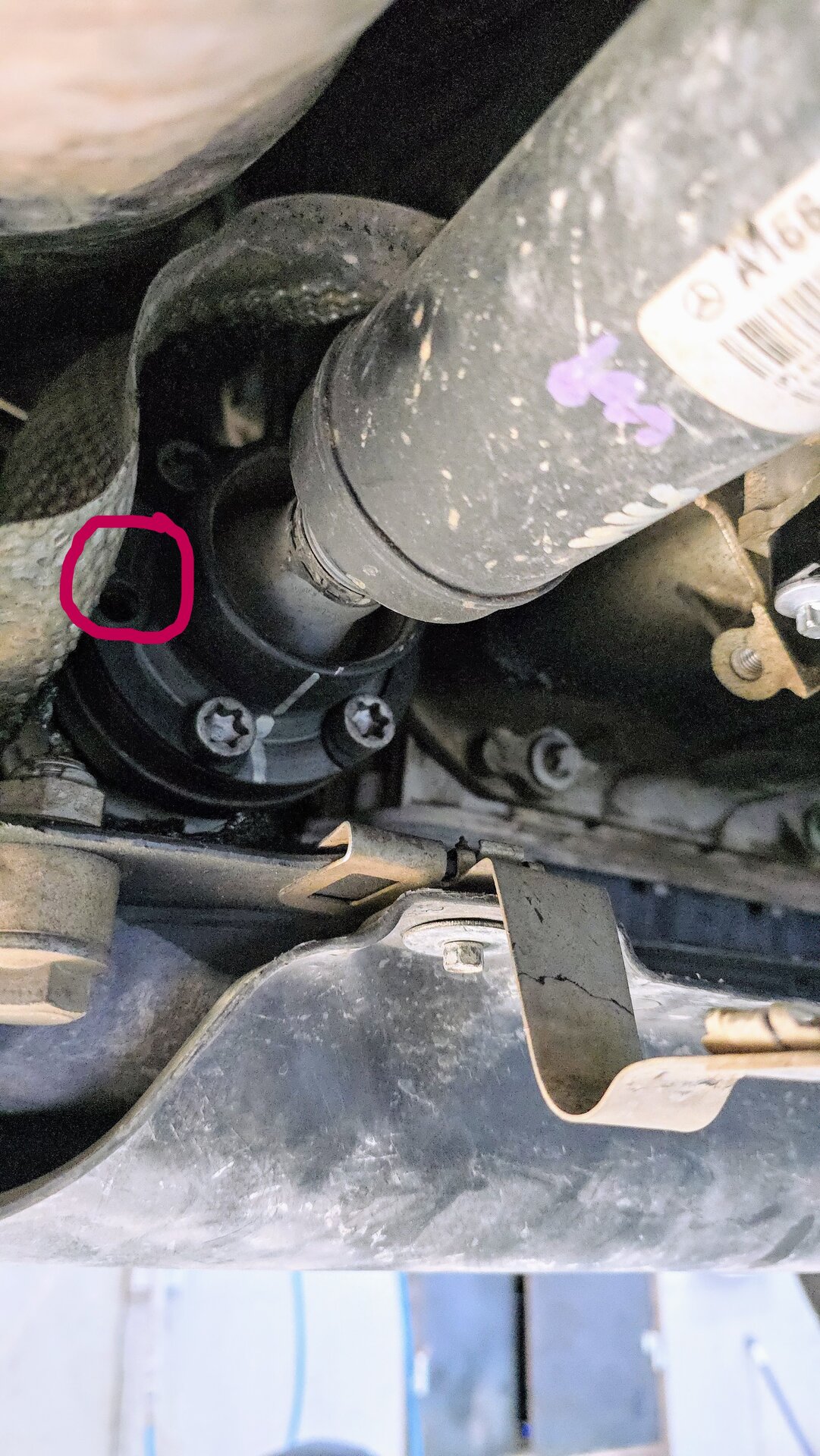

Solved! It took a while, but here's the update.
We started by balancing the wheels and tires in three different shops, but unfortunately this did not solve the problem.
The cause appeared to be the transmission, as it was causing a high frequency vibration.
I decided to start with the transmission torque converter. When my W166 reached 100,000 km it was time to service the transmission and I added an anti-shudder additive to the torque converter. I have had good experiences with this product since I became a Jeep owner.
While working on the transmission, the mechanic noticed that a bolt was missing from the front drive shaft:
20240625_132954
When we tried to insert the bolt, it turned out that there was no thread, so we fixed that too.
Thanks to the new transmission fluid and filter, and the installation of the missing bolt, my W166 is vibration-free, as confirmed by tests at speeds up to 160 km/h. There are still some things that need to be fixed, but I'm starting to like this beast.

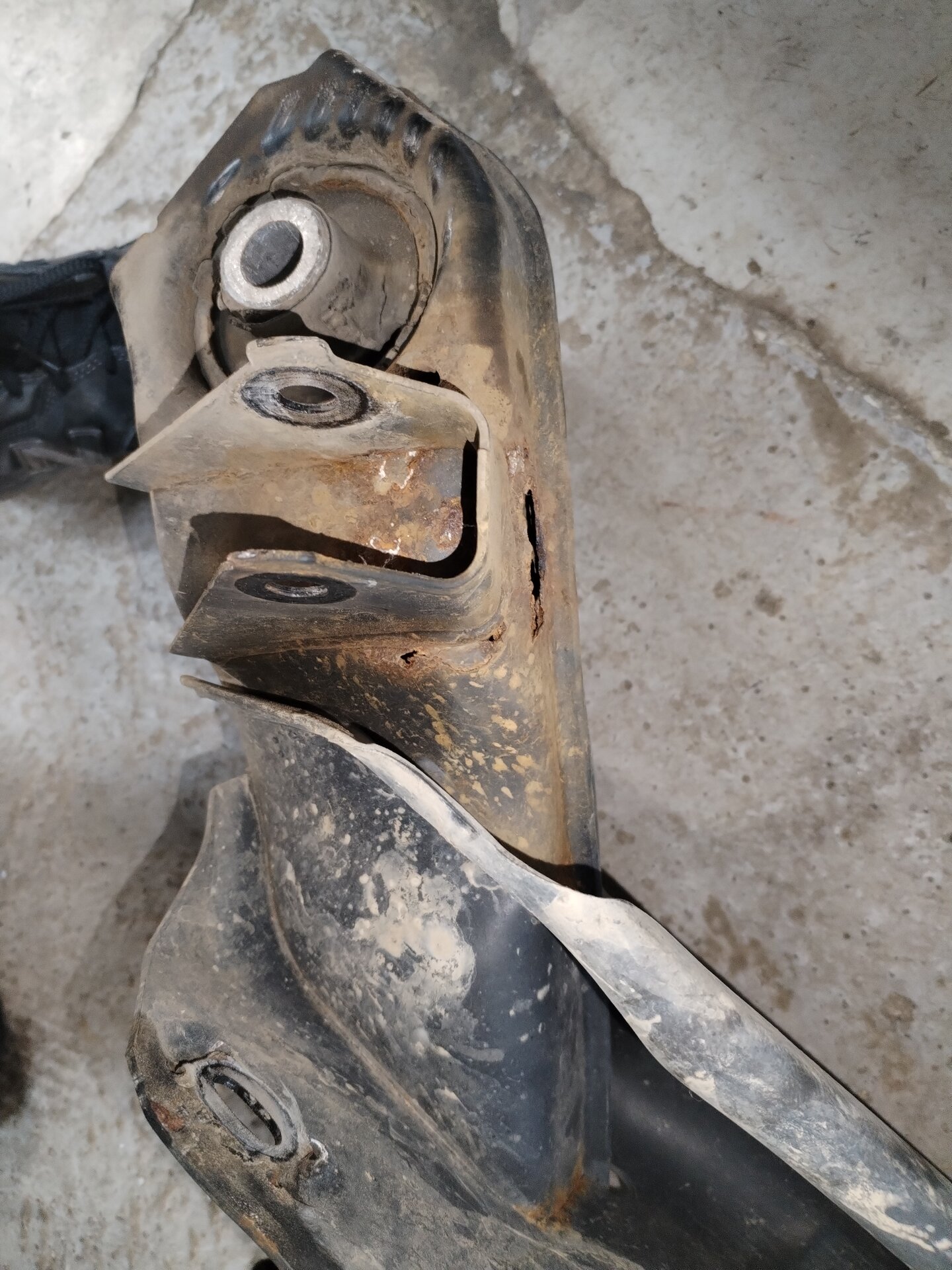

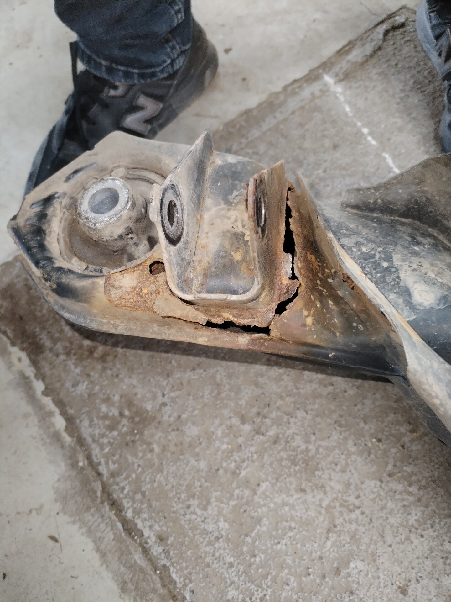

The same thing happened to my car. I found that the subframe was rusted and partially broken.
