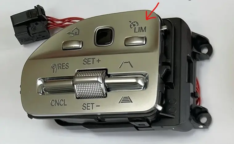

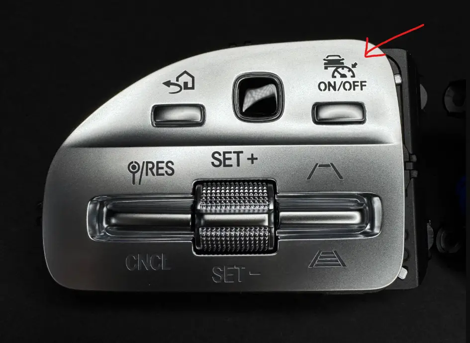

Which buttons are below? A or B? How do I know which one is right for my car to code it?
A.
1747935478921
B.
1747935927452
The A button is in my W177 A35 AMG. Although my Distronic set is on the right side, since I have a RHD car.
