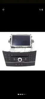

Found a kit with a system and display from W212 at a good price. Do I need to adapt something in the connectors to make it work?
Part number: A2129004208
The lower part (head unit) works on the "plug and play" principle.
For navigation to work you may need a GPS antenna (3 euros on AliExpress).
Since this is a COMAND unit, the display power connector needs to be rewired. In addition, the large display does not fit under the cover.
The scheme is attached.
So could the cable to the screen be the same as the Audio 20? Do I just need to re-solder the contacts that go to the little sensor on the flip cover?
Is any coding required for a car to accept the system?
I don't really need GPS, the main thing is that the radio and Bluetooth work.
Yes, it's the same cable, just the pin order is slightly different.
To switch from Audio 20 to COMAND it is always necessary to reorder (or resolder) the connector.
The sensor on the lid is not needed because of the large display, it can be cut off (although I left it and sealed it with tape).
No coding required, just plug and play.
