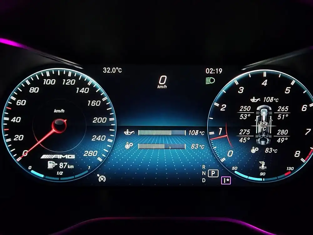

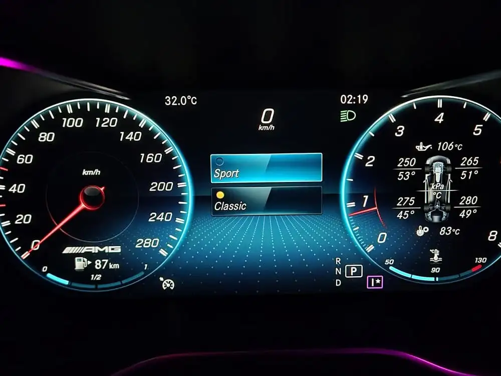

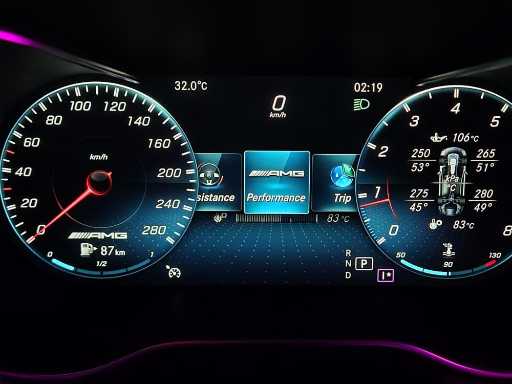

I recently activated the AMG menu on my IC213, and it works perfectly. I noticed that the Progressive design has disappeared from the design menu, and it was supposed to be replaced by the Supersport design. On my radio, the Progressive design has also disappeared, replaced by the Supersport design. However, I can't access this design now because my dashboard only has the Sport and Classic designs. How can I get the Supersport design to appear on my dashboard?

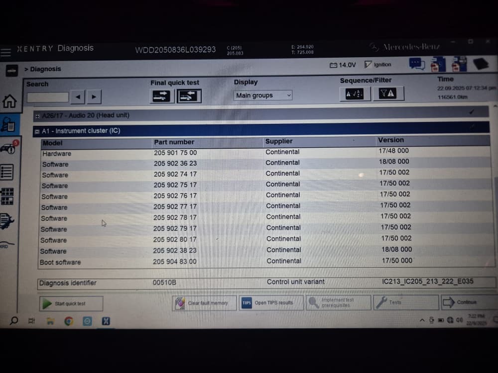

My IC213 details:
HW 205 901 75 00 VERSION 17/48 000
SW 205 902 36 23 18/08 000
SW 205 902 74 17 17/50 002
SW 205 902 75 17 17/50 002
SW 205 902 76 17 17/50 002
SW 205 902 77 17 17/50 002
SW 205 902 78 17 17/50 002
SW 205 902 79 17 17/50 002
SW 205 902 80 17 17/50 002
SW 205 902 38 23 18/08 000
BOOT SW 205 904 83 00 17/50 000
IC213_EO35
I found out that I need to reflash my device to a newer firmware version. I currently have firmware IC213_EO35 installed. I found the firmware file IC213_EO43. Is this possible?

I already did that. It still doesn't show up.
