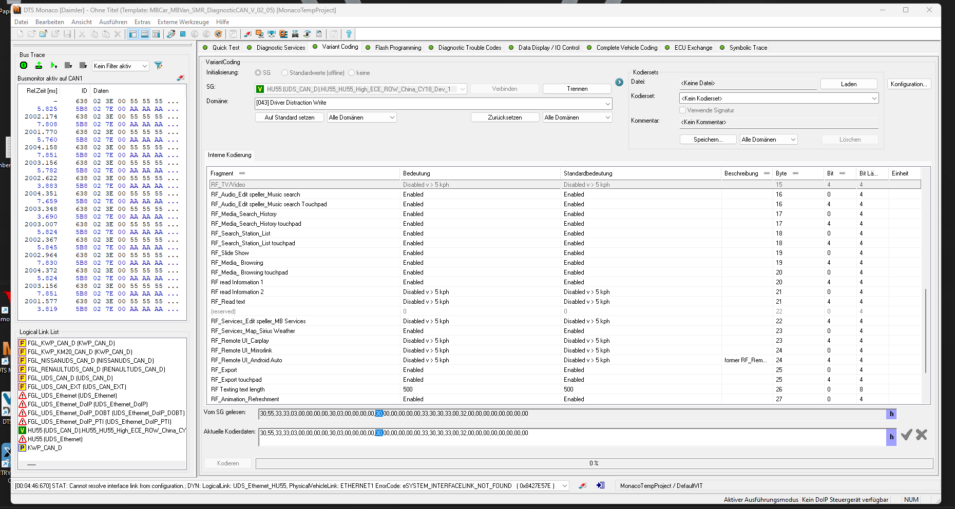

I have a 2019 W213 E450. I searched for information on activating the "Video in Motion" feature for HU55 but found nothing. Is it possible to code it? I tried to manually set the code to 00 but it did not work.
I took a screenshot, maybe someone can help me.
Have you searched in other ECUs, for example PARKMAN213?
Video in Motion.
PARKMAN213
Functional Settings Write
SVS: Views Speed Limit Activation -> FF
SVS: Views Speed Limit Deactivation (High/Entry) -> FF
SVS: Views Speed Limit Deactivation Frwd (Entry) -> FF
The coding above ("FF") is done directly in the "Current Coding" line (not from the usual drop-down menu), then you should click the check mark and click "Do Coding".
You may find similar coding options.
