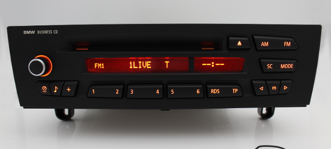

Does your E90 have a single or double hump?

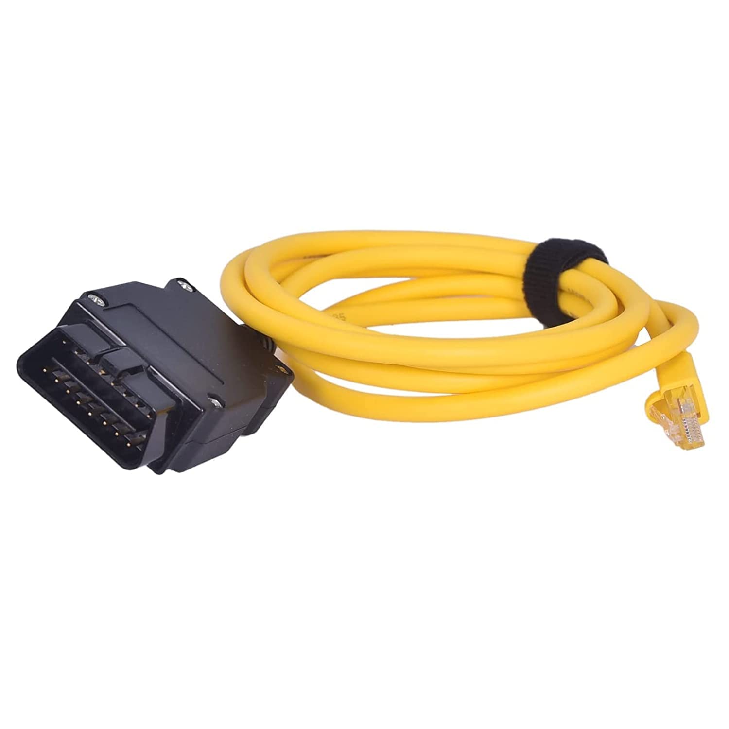

Maybe I asked the question incorrectly, I have an ENET cable, I'm waiting for your suggestions and software, thanks in advance.

As far as I know, you can't use ENET to code E90. ENET cable + E-Sys software are for F and G series. For E series you need K+DCAN and NCS Expert. If your car is older than 2007, you can use K-line cable.
Reactions:starcan

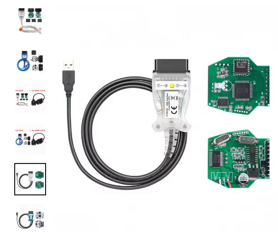

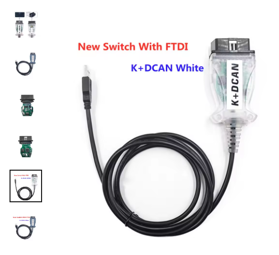

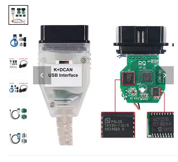

Looking at the pictures, which one would you recommend me to buy?
I have a second one and it does the job perfectly.
Reactions:jon and ricardo_s79
I took the first one, and it works too.
And yes, you cannot use ENET.
