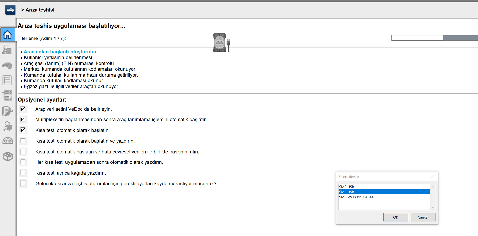

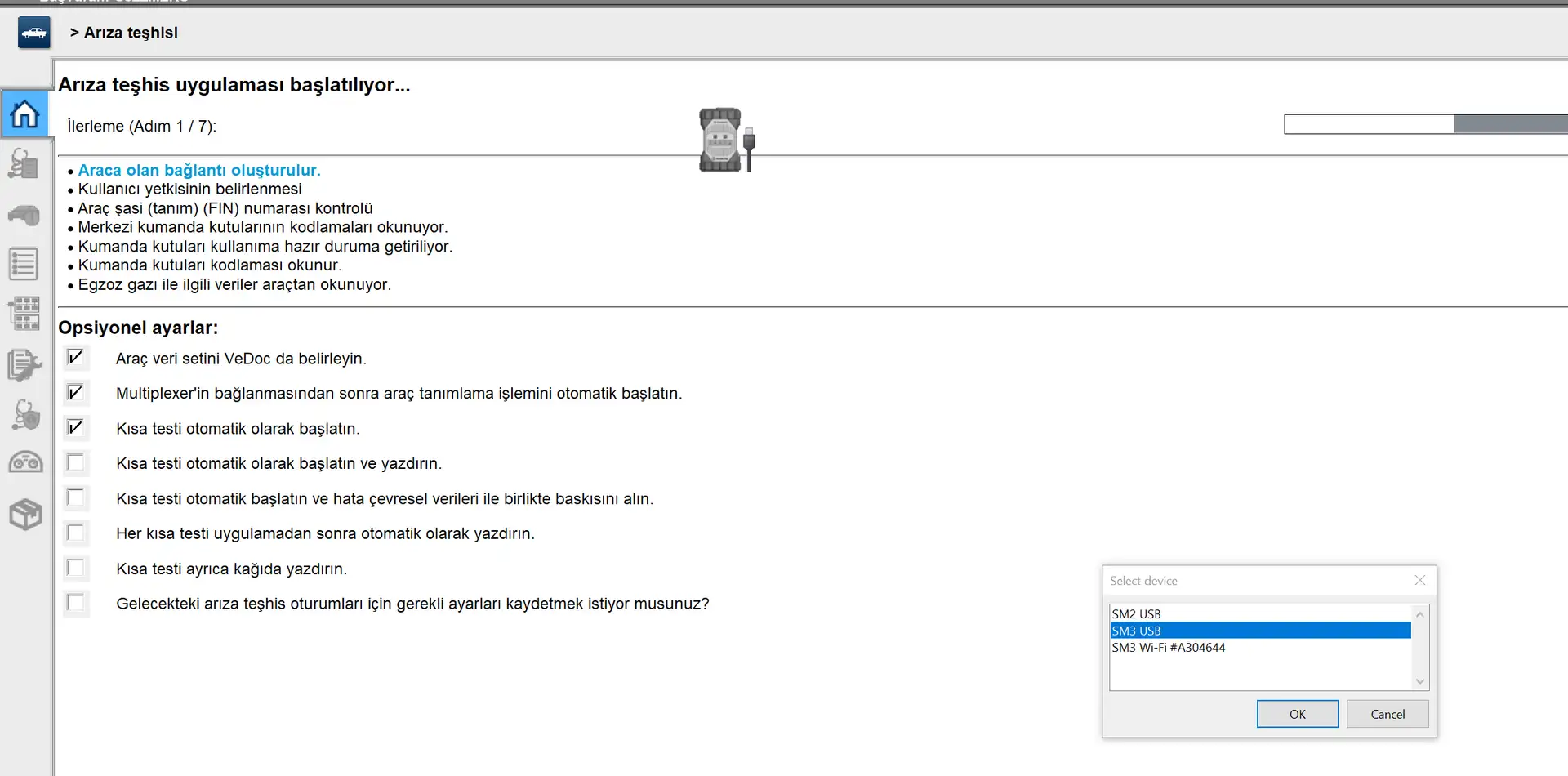

I have installed XENTRY 2026.03 version.
Just a few days ago, I was using this system with the original VCI C6, and there were no issues.
Yesterday, I updated the WiFi and software of my original Scanmatik SM3 scanner.

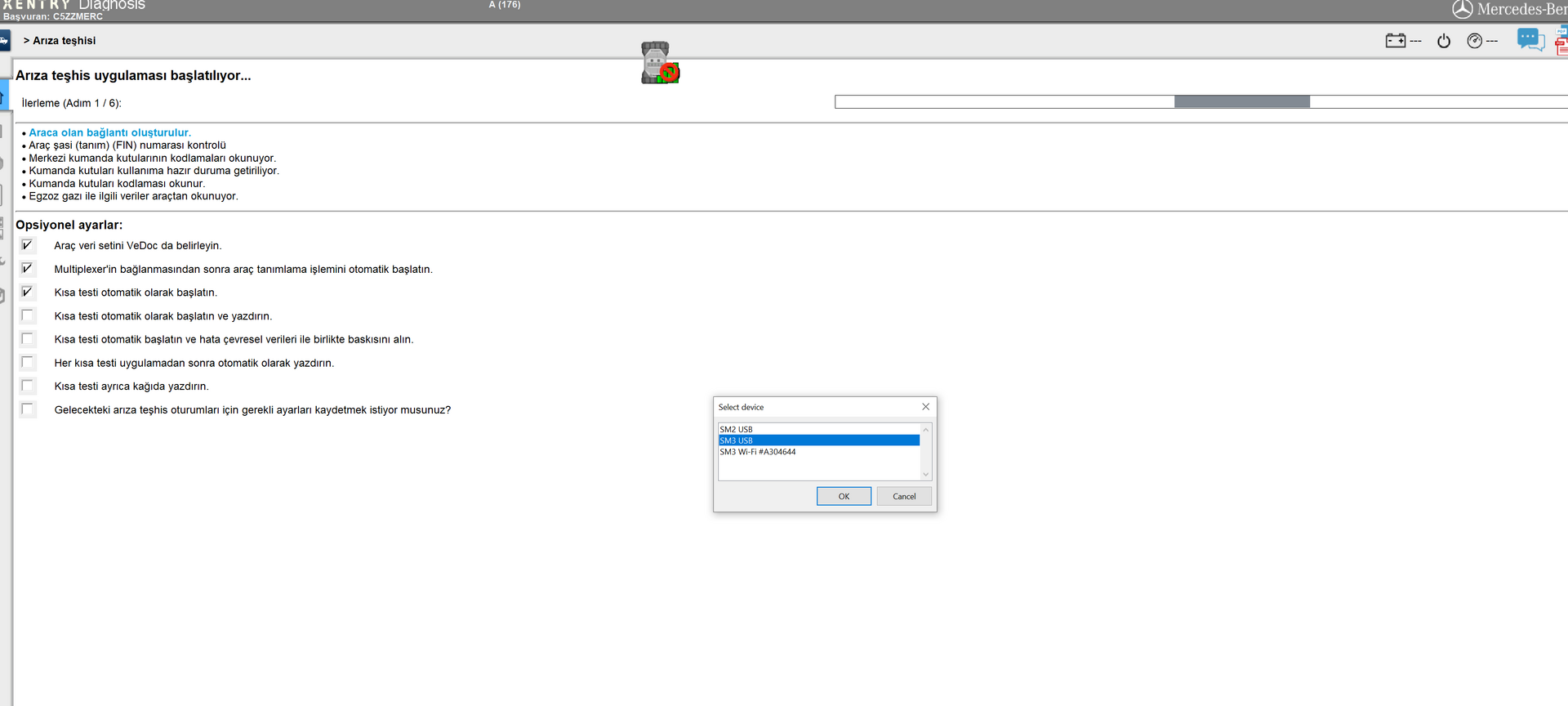

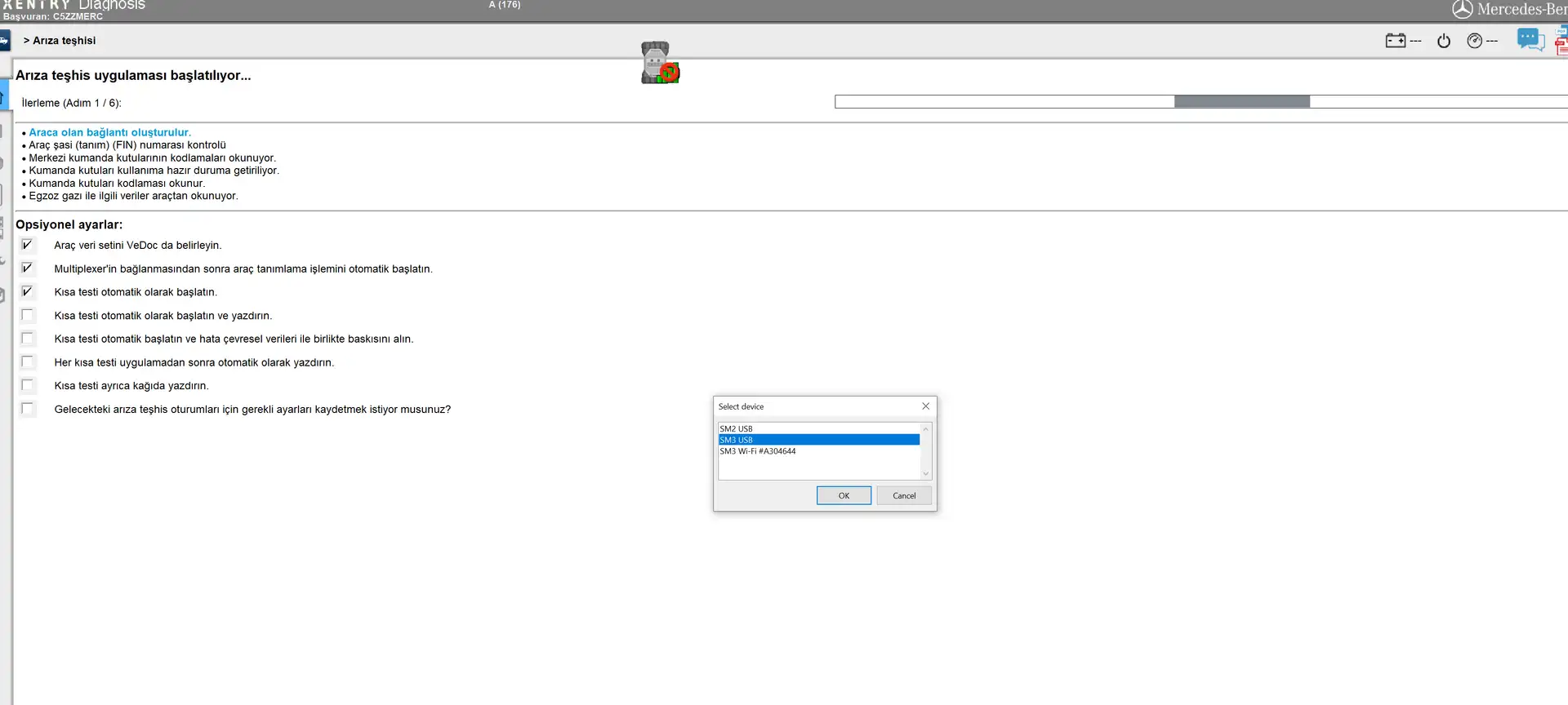

Since then, XENTRY and DAS have been asking me to select a PassThru device.
The funny thing is that once I've selected an interface, I can run diagnostics on the car using that interface (SM3 WiFi or USB).
The VCI is still recognized but connects to the car only via Scanmatik.
It does not matter whether the VCI is connected or not.
XENTRY is an XDOS installation.
Has anyone encountered this problem yet?

It is obvious that the SM3 program secretly modified the XENTRY configuration file. That is precisely why I hate these J2534 devices. If you cannot find exactly which data was changed, the only option left is to reinstall XENTRY.
