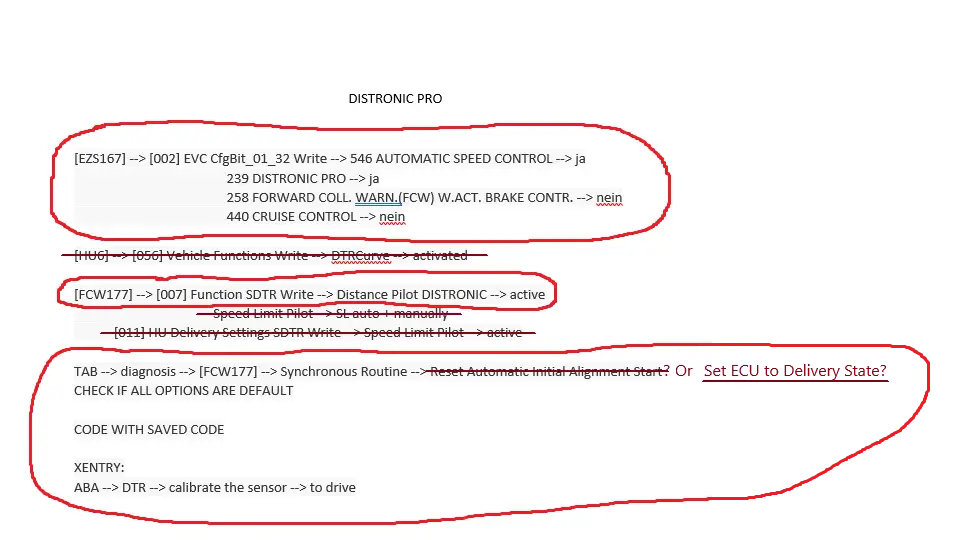

I hope to be useful for someone, this is the string code to activate Distronic Pro in W177 (and also in other models).
Distronic Pro

Does this apply to the W177 facelift or only the PL models? Thanks!
Other tutorials only include the steps marked in red (see my picture below). Why did you add other steps?
They also suggest using "Set ECU to Delivery State" instead of "Reset Automatic Initial Alignment Start" in DTS Monaco. Is there a reason for this difference?
Finally, to reset FCW177 in Xentry, the manuals mention that it should be done under "Collision Prevention" but I only see "Active Distance Assist DISTRONIC (DTR)". I'm trying to figure out why "Collision Prevention" isn't showing up in my Xentry. Or is it possible to reset FCW177 in "Active Distance Assist DISTRONIC (DTR)" using Xentry?
