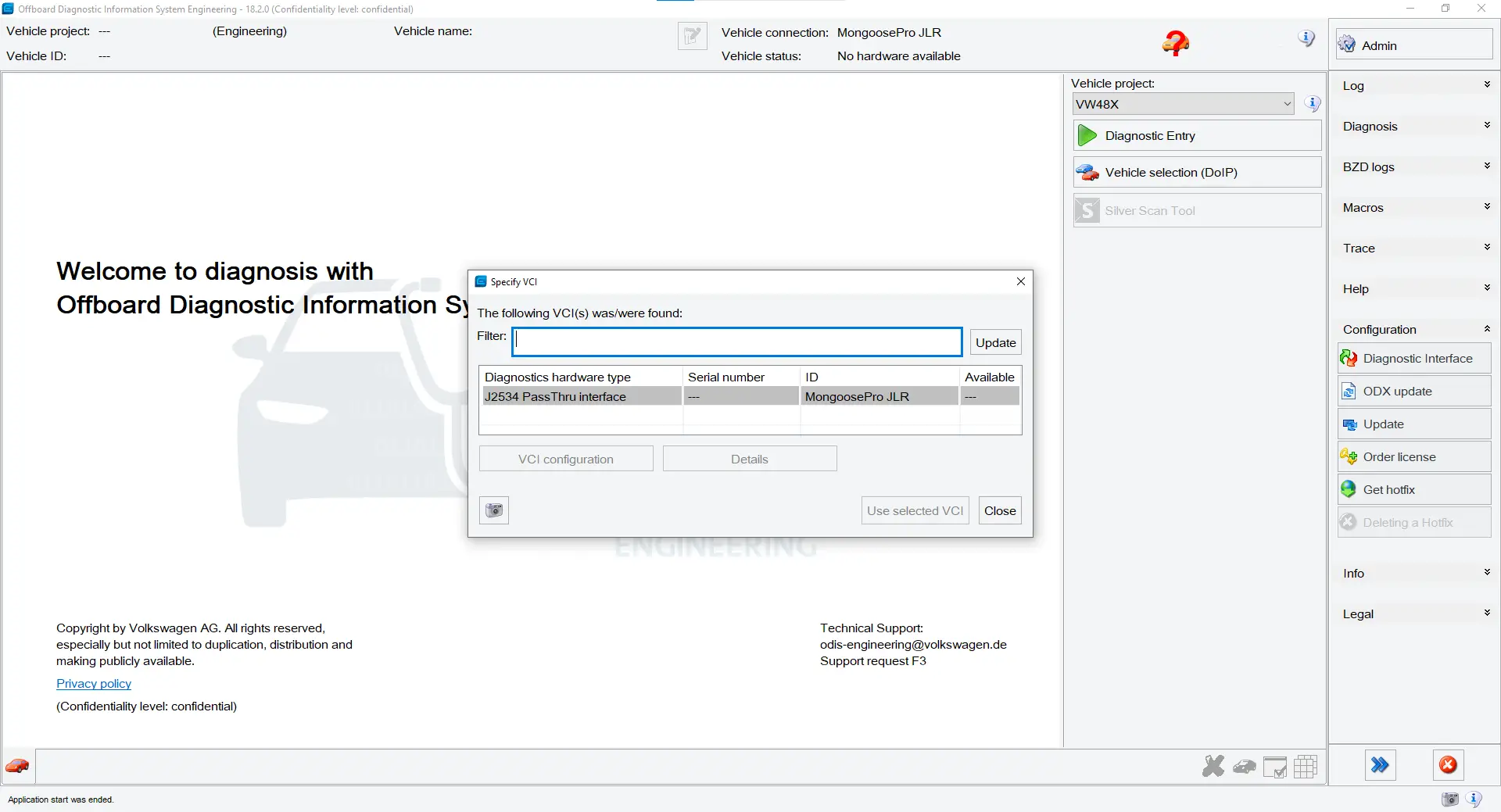

I have a Mongoose J2534 clone that can be updated via the official Mongoose website. Will it work with ODIS and if so, is there a specific setup guide?
As far as I know there is no manual for VCI. Install the drivers and go to "Extras/Diagnostic interface", run the test and accept it if recognized. ODIS is very picky about VCIs, many of them don't work unless there is a patch for them.
Reactions:Ak22
I installed ODIS-E 18.2.0 and during installation I selected "Passthru". After the first launch of ODIS-E, it immediately showed the Mongoose Pro JLR, even without any action. I installed the drivers for this cable and used it with Techstream for my Toyota, so I guess it picked it up automatically even though it's a J2534 cable. Although I haven't tested it on a car yet (I need to find one first), that will be the final test.
1750604911862

Update to my post above since I can't edit it, I tested the referenced cable with a car today and it works!
