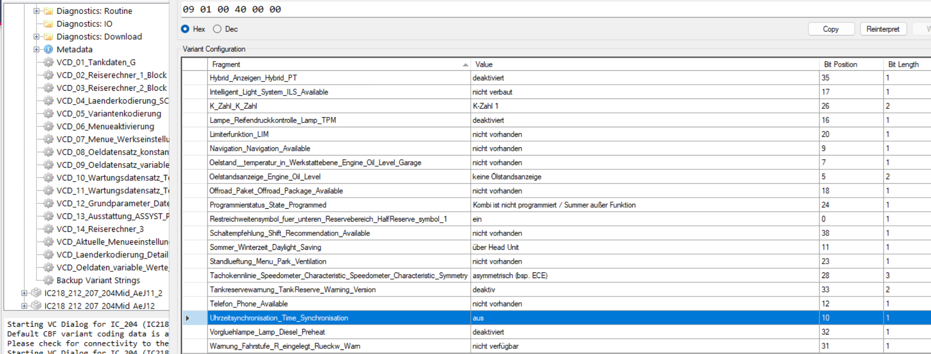

Try coding time synchronization on IC204, domain variant coding.
Reactions:W212E200
You need to change the coding in IC204. Go to VCD_05 and change Uhrzeitsynchronisation_Time_Synchronisation to "aus".
Reactions:W212E200
