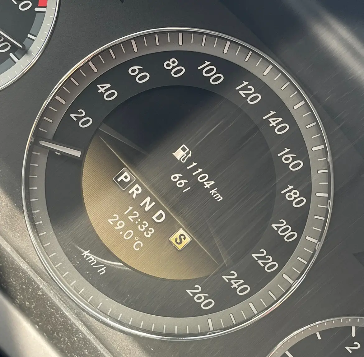

Just found an old photo. Full tank 66 before IC replacement.
IMG_0159
Actually, mine looks the same. When I drop it to 0 liters, the maximum I can fill is about 60 liters. So, as bogdandpr said (y)

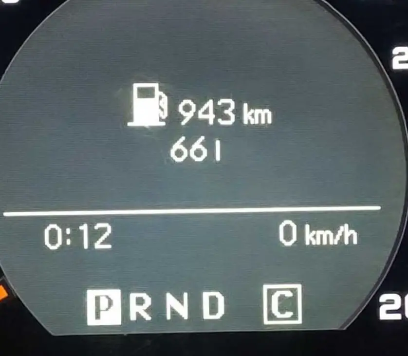

Okay, I fixed everything today. I filled the tank to the maximum and using Vediamo on IC_204 replaced the 59L_V5 module in Tankdaten with AMG_V4 and now it shows the correct volume of 66 liters :)
IMG_0331
Reactions:daniW204
Looks great (y) I think I should measure mine and change it too. It is quite interesting that when my IC shows 0 liters, I can only fill up to about 60 liters. I always thought the 320 CDI had 66 liters. Can you fill your tank to almost 66 liters if it says 0 liters?
Reactions:B0bby92
Mine displayed 9 liters remaining and I filled 56-57 liters. This gives me 100% confidence that my tank capacity is 66 liters. As shown in the old IC. Now, after correct coding, everything is fine.
