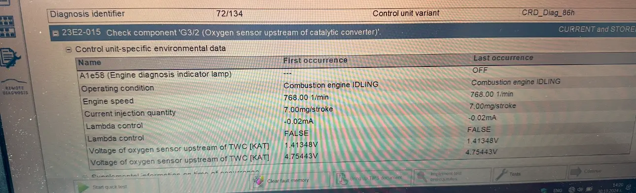

I would like to note that the fault may also be in the torque converter clutch bypass valve - it stalls. Diagnostics does not reveal this defect. Again, this can be found out from the actual values - consumed and actual current (A) for a given valve. Again, the test can be performed by disabling (XENTRY) the inverter bypass clutch. Applies to gearbox (722.6).
I don't have this option on (722.640).
Load it in DAS as prototypes (you must have an old version of diagnostics, ideally 10.2008 or modified DAS prototypes).
The rest is according to the screenshots.
I don't know if XENTRY has such a feature.

In XENTRY when I do "Reset values of quantity mean value adaptation". It says: Do this if you have replaced: MAF sensor, fuel injector or O2 sensor. And that makes me think that O2 sensor plays a role in fuel quantity adaptation and performance :)
