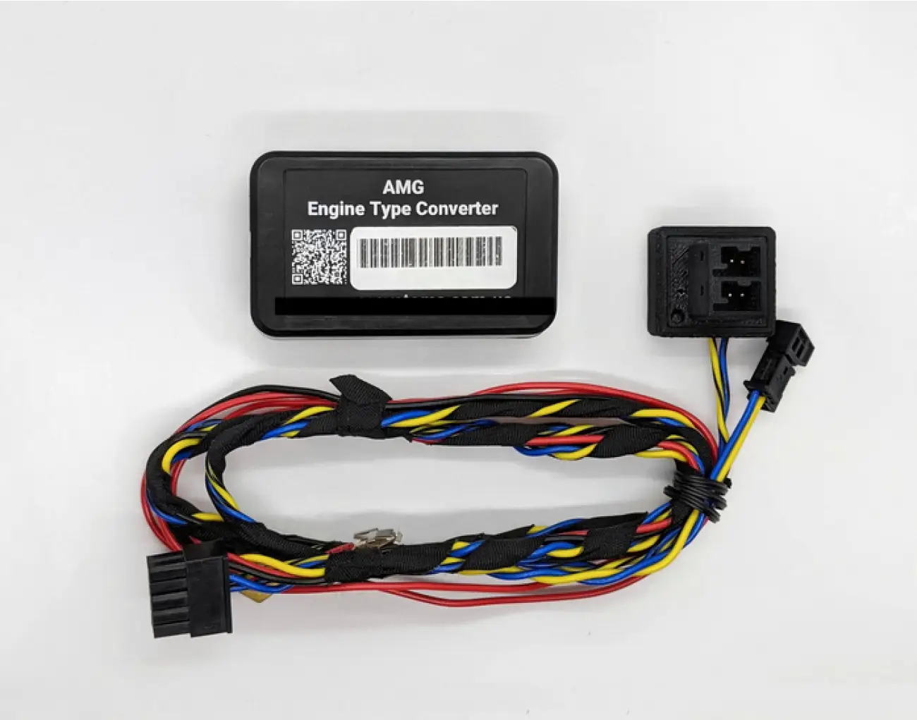

AMG Supersport Screen on Instrument Cluster
A200 does not support because it uses 1.3L engine. But the Emulator device you see in the picture below can be connected to the car and activated by coding.
IMG_8214
