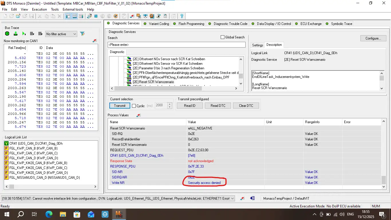

I found "Reset SCR Warnszenario", but it says "Security access denied".
I tried another CR41 file, it's still blocked.
Screenshot 2025-12-15 185833

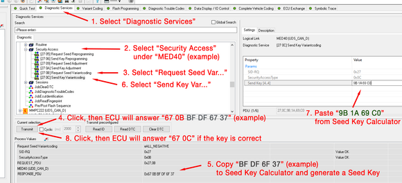

Or you first need to unlock the SG using a Seed Key Calculator. But this process is complicated.

Thank you, kenaj23, everything is sorted.
I had to use a key generator and insert the seed key.
After running "Reset SCR Warnszenario", only two of the three fault codes were successfully deleted.
I ran Seed Key Generator again, then ran the "Reset SCR Warnszenario" again, after which the last error code was reset and the countdown disappeared.
