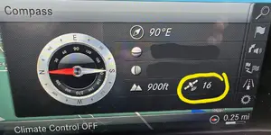

Check your NAV and/or Xentry settings to see if you have any satellite locks. The vehicle must be outdoors with a clear view of the sky. Technically it should show 8-11 satellite locks. If it shows zero, it is definitely the GPS antenna.
Just in case. This is done through navigation (Xentry is not needed). The car was located outdoors, in a place with a good view of the sky. Note that I captured 16 satellites (both GNSS and GLONASS).
