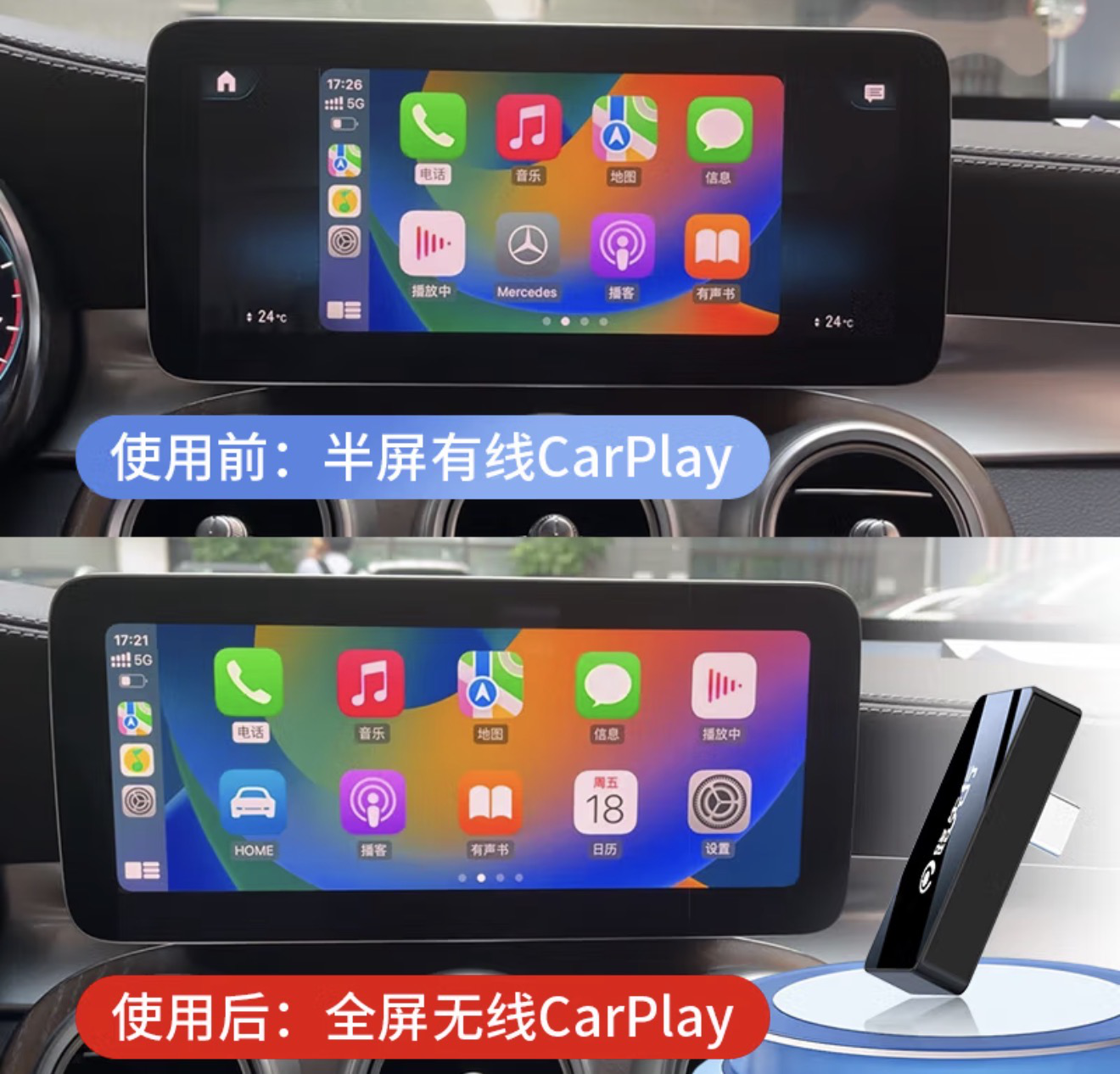

There are two ways to activate CarPlay and Android Auto.
1. Activating with Mercedes ME
2. Hop6uK can make changes to the head unit remotely with a special method
2.1. This method can unlock CarPlay and other features.

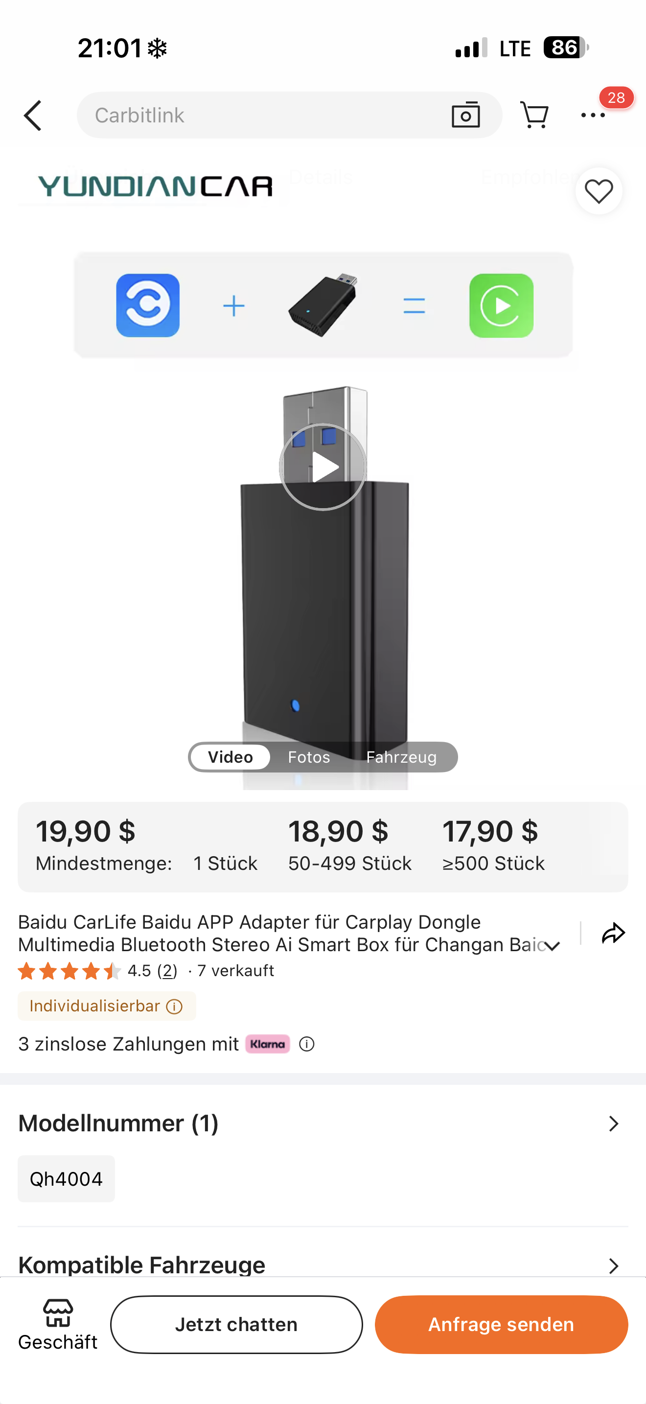

The beauty of this method is that in addition to CarPlay and Android Auto, it also allows you to use Baidu CarLife, navigation, lifetime free navigation updates without entering a code, AMG Track Pace, dashcam and engineering mode. I would also like to point out that there is a way to use CarPlay fullscreen without an interface (module). It works with CarLife. CarLife supports fullscreen mode, and you can use CarPlay fullscreen mode with the CarLife to CarPlay device without making any changes to the car or installing an interface.
CarLife to CarPlay device:
CarLife to Android OS device:
CarLife to HiCar (Huawei):
