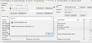

Regarding VMAX coding, the main post suggests using CPC_NG, but I noticed that VMAX can also be set in EMS71. Can I use EMS71 instead? I tried to code it in EMS71 but got security access denied (33). The following steps were performed:
1. "Extended Start" for EZS167.
2. "Security Access Level 3B" for EZS167 to open the firewall.
3. "Extended Star" for EMS71 which gave several errors.
4. "Security Access Adjustment" for EMS71 to open access to this ECU.
I also tried running "Extended Start" for EMS71 again after "Security Access Adjustment" but still got the same errors as in step 3.

I coded the EMS71 to increase VMAX when reversing over 30 km/h, but the rear parking camera still turns off once I exceed 30 km/h. Before drawing any conclusions, I wanted to test whether the VMAX setting had any effect by dropping it to 20 km/h. However, I was still able to reverse at up to 25 km/h, suggesting that the change had no effect. I also tried disabling the ECO Start/Stop function in the EMS71 to see if my coding worked, but it remained active. Based on this, it looks like none of my changes were reflected, although DTS Monaco did show the new values I was able to code. So I can't confirm that VMAX for reverse is the real reason why the rear parking camera doesn't work at any speed.
I used seeds and keys for variant coding in EMS71, but "Synchronize to Non-volatile Memory Start" failed due to lack of access rights. I assumed that this was not necessary since the coding was only for testing and not for permanent use.
